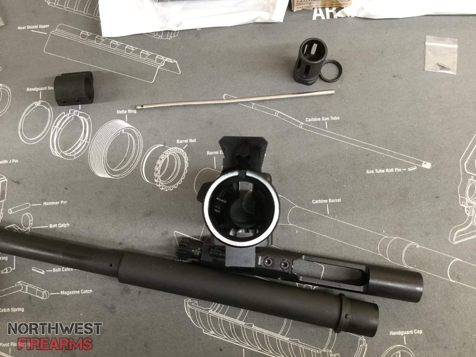

Well all my parts showed up finally and I threw down and built out the upper this afternoon. Barrel looked good but I have my doubts about the melonite finish as it looks more like a standard phosphate to me. The m4 feed ramps are the typical window peak design but they mate well with the ones in the Anderson slick sided upper. Started with lapping Anderson upper to assure barrel has even pressure on flange and stays straight. Build went without issue but had to add shim to get proper torque and line up gas tube with barrel nut that came with no name key mod hand guard. IMG_0808.JPG IMG_0810.JPG IMG_0809.JPG

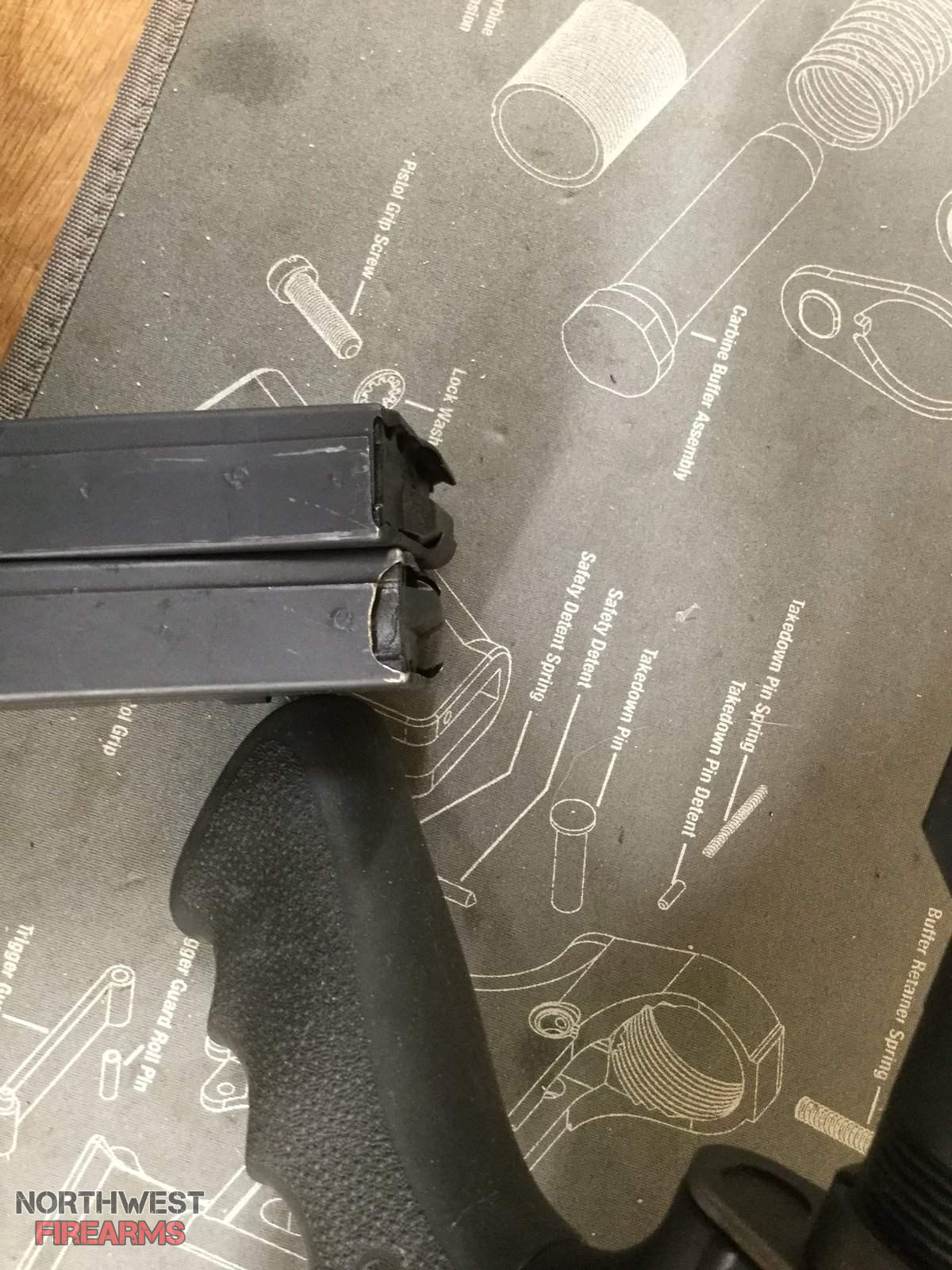

Mated with a Rock River arms lower I had and she is tight. Worked bolt carrier group a few times and dry fired and checked safety function which all seemed fine. Mounted cheap millet red dot and magpul buis. Pulled some bullets out of wolf ammo and dumped the powder charge and reseated bullets to make some dummy cartridges. They seemed to cycle out of the non modified 20 rd asc mag better than the 10 rounder I carved a half moon out of the front of as the cartridges seemed to catch on the cartridge neck when pushed out of mag by hand. That may have been an unnecessary mod but we shall see after live fire. IMG_0822.JPG

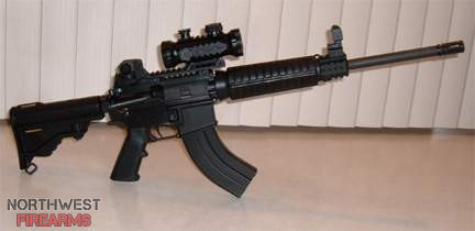

.:s0090: IMG_0821.JPG
Can't tell from the picture..Did you co-witness your Red Dot with your BUIS ?o_O
If you did, you can always verify the Red Dot by flipping up your front post.;)

Checked headspace Friday and was good to go. Went to range today and ran 100 rds of Wolf military classic 123 gr hp through her. When using 10 rd ASC mag I modified it ran 100%. Both unmodified 20 rounders were fine at 10-12 rds but spring and or follower bound up when trying to load more. Also another unmodified 10 rd ASC would not feed first round when over 8 rds was put in mag. So my impression is no mods whatsoever are needed on feed ramp or barrel gas port. It seems to be gassed almost perfect. All feed issues seem to be mag related. On the twenty rounders it seems when loading much more than 10 rds. (about where curve in mag really starts) the rounds did not have proper upward force under them and would not feed. This was very apparent as mags were loaded. I will mod other 10 rounder and probably mess with on of the 20's as well to see if I can correct. I may also try a C products mag. The really good news is this damn barrel shoots! Lots of 1" 3 shot clover leafs while dialing in at 50yds. After getting dialed in I punched out the bull with 10 rds twice once with red dot and once with the back up magpuls. At 100 yds with the magpuls I shot a 3" 5 shot group right before leaving the range. Considering my aged eyes and cheap steel cased ammo that as as good as it needs to be. Can't wait to work out mag issues and put in some more range time. I might even scope it and see how she will really group.

Just a bit of a follow up and final synopsis after a range session this afternoon. Bought some C defense products mags to try in 10,20, and 28 round capacity. I am very pleased to report these mags ran 100% during this session of 80 rounds. They were all loaded to full capacity and unmodified so they are definitely the way to go in the ARK as I have come to call it. I would recommend them over the ASC mags. And again I experienced excellent accuracy with this budget priced barrel. I scoped it up and found it clusters three shot groups at .625-750 inches with boring regularity. I also shot several 5 shot groups that were .875-1.0625 inches. A couple 10 shot groups averaged 1.625 inches. This is all at 100 yards with cheap Wolf steel cased military classic 124 gr. hp ammo. I am very surprised at the lack of issues I had with this build and equally as surprised at the accuracy. I will be keeping this one in the stable for sure. The only change I might make is a low power tactical type optic to live on top the rail. I highly recommend a 7.62x39 upper for any AR enthusiast.
