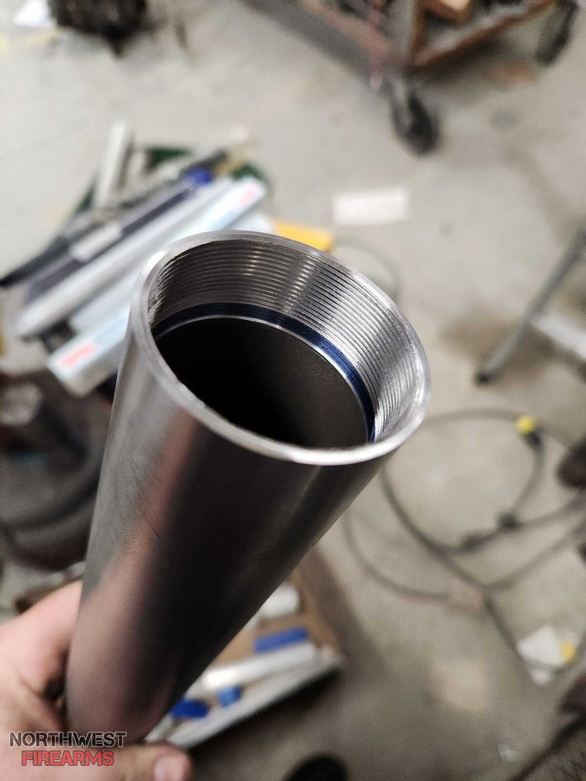

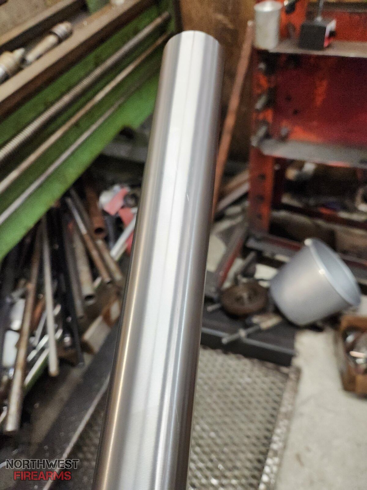

16in long x 2in diameter, Titanium thread sleeve, 416R stacked machined baffles (radiused and clipped). 1-14 threads for my MCM50 single shot.
I've always been worried about machining Ti and now I'm not. Turned with coolant (I know the fire risk of Ti) 18in chuck to center. It chirped a bit but finish was good.
It is certainly stringy and the strings are sharp.

That might be the biggest can on this site. I'd like to see the finished product and results of sound reduction.

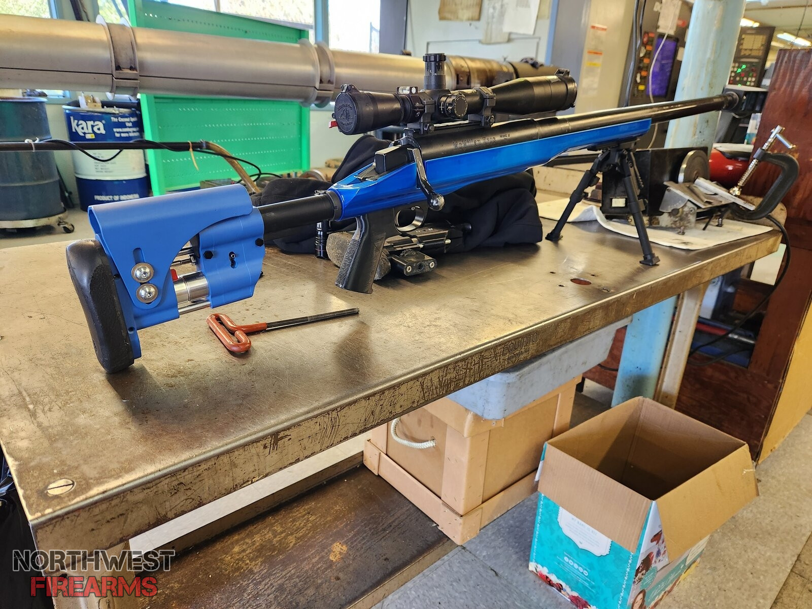

First dry fit! Alot of trips to the shop to change parts. A 1-14 hand tap wasn't a good idea, needed a big wrench. Weight was what was expected, maybe a little less.
Need to spin out a 49/64 -20 adapter tomorrow since I don't have a good spot to shoot 50BMG. Time to turn that 16in barrel in to a 32in barrel....
What's left of this .502 bore barrel could make a .510WSM pistol (Omen pistols seem envogue right now).

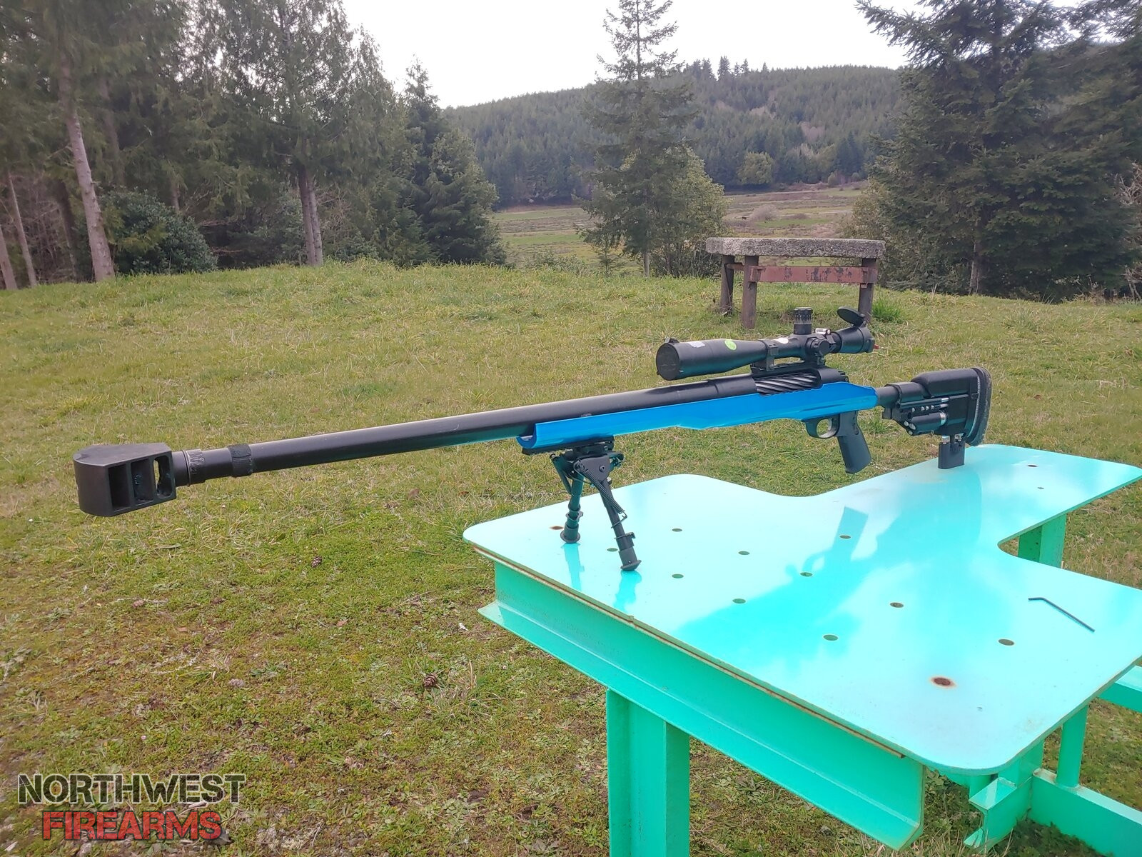

Love to know how the recoil is with suppressor vs giant break.
Are you machining your own break or using the AAC or similar?
