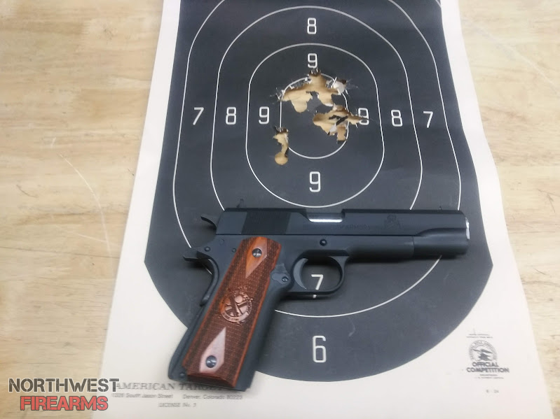

Standard reduced load for the 45 auto I have been using for many years. It is also very accurate
'Target' load. 200 SWC and 4 grains of Bullseye. It will function with standard recoil springs.
The 1911 barrel will need to be 'Throated' as most of them are now, to feed SWC bullets reliably.
I now use the coated 200 SWC bullets from T & B. I have used this load in a dozen different
1911s with excellent accuracy. Titegroup I have tried did not match the accuracy of Bullseye.
