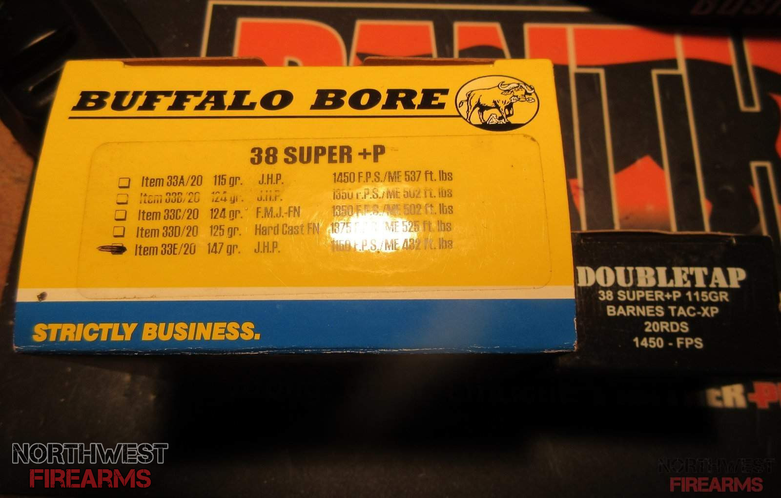

If you will pardon the digression, what are carrying in .38 Super? I have always had an interest in the cartridge, and the fine classic firearms so chambered. Thanks. :)
I use the heavier Buffalo for campin and the double tap for home defense.
reloading Ive used 7.8 gr Blue Dot with a 147gr XTP.

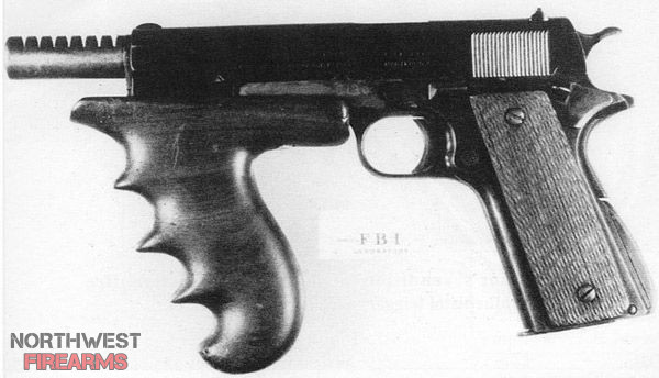

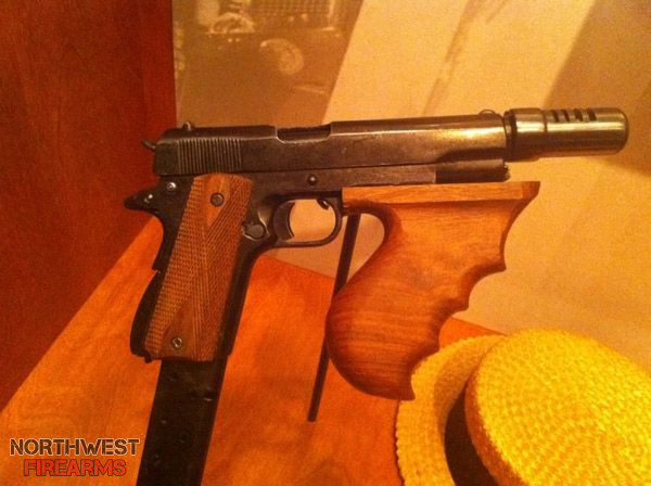

.38 Super has always intrigued me, kinda like a 9mm on steroids. I believe it was John Dillinger who carried one and preferred it for its ballistic performance against automobile sheet metal of the day...
