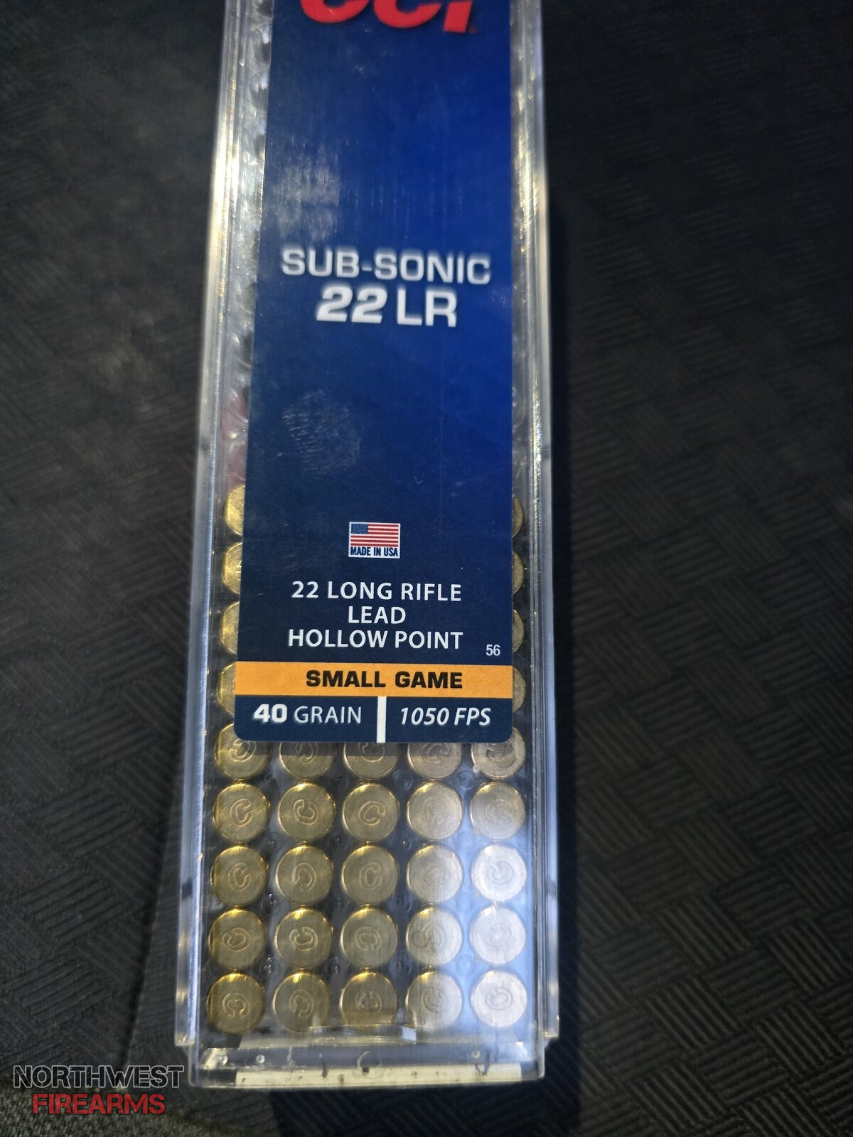

I just buy cci sub sonic hollow points.....I dont want my grouse to turn to mist.....🙄

I honestly dont think 30fps makes that difference. Ive shot 10s of thousands of animals with the subs, including bears and cougers.

That.. and how soft the Lead is . I find CCI lead blend is pretty hard in comparison to Aguilla Lead . The Aguilla lead is softer, and Subs are much easier to re-shape/open-up the HP holes to Bigger.
I really prefer to shoot Subs for Big-Hole HP's, but I never used the marketed bullet tip dies . I made a small jig and just use a 60 Deg. center in a small lathe to open-up the HP holes to the desired size I want. and basically Bigger the Hole, it's Bigger the POP .
