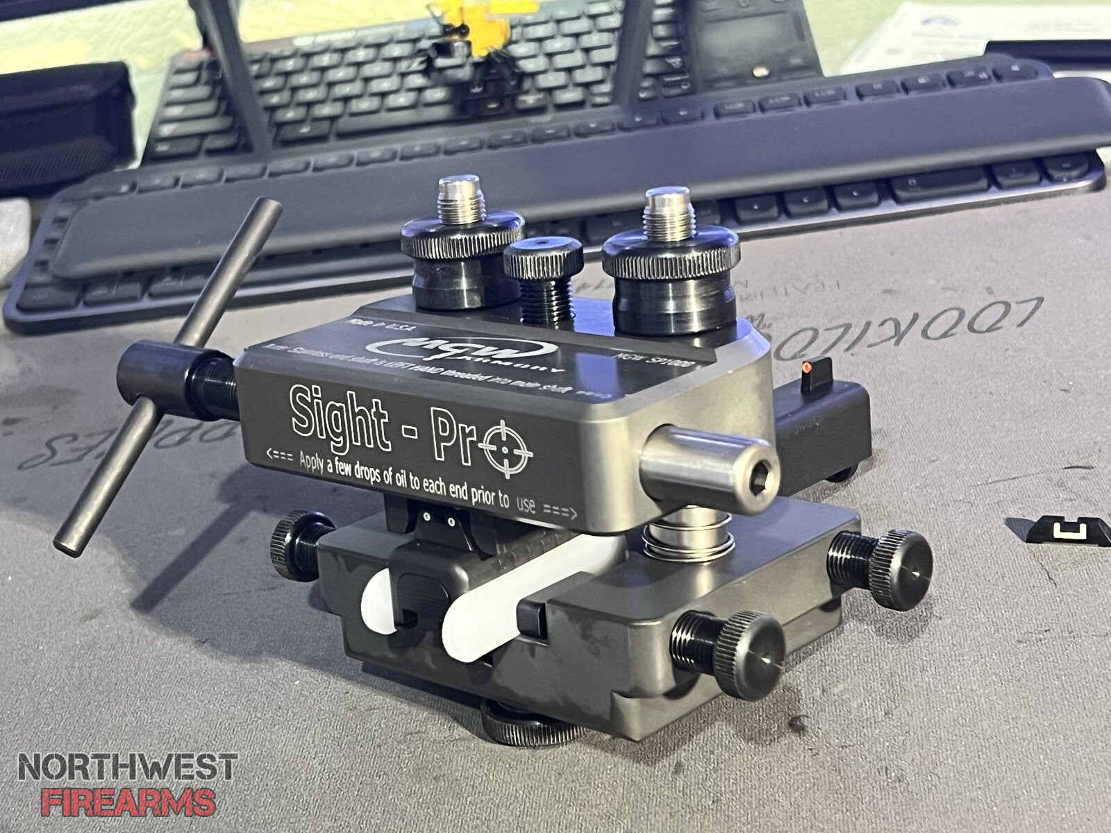

Buy this and don't look back. I use some blue painters tape and some sticky notes as shims on oddball slides and areas of metal to metal contact. No sight pusher can fix stupid. You still need to make sure your fit is good. This one will lock your slide in tight and move the tightest of iron sights. If the new sight fit is too tight you easily remove the pusher block and swap it to the other side of the sight and push it back out.
Make sure the pusher block is set low on the sight but not so low it hits the slide. It works excellent on the Glocks. Read the reviews for a lot of good information.
