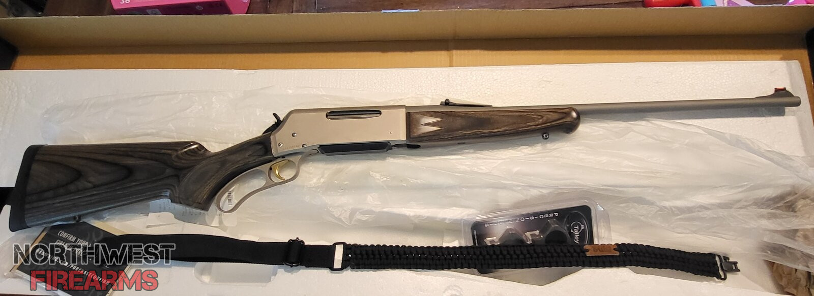

Well I made my decision, and went with a BLR in .30-06. I found this one with the unique combination of a laminate stock and a curved grip (previously I had only seen laminate stocks on straight-gripped takedown models), so I decided to jump on it. Haven't shot it yet, but I'm looking forward to it.
Thank you everyone for your input!View attachment 2077852
That's a sharp looking rig! You don't see many stainless BLR setups in the wild.
