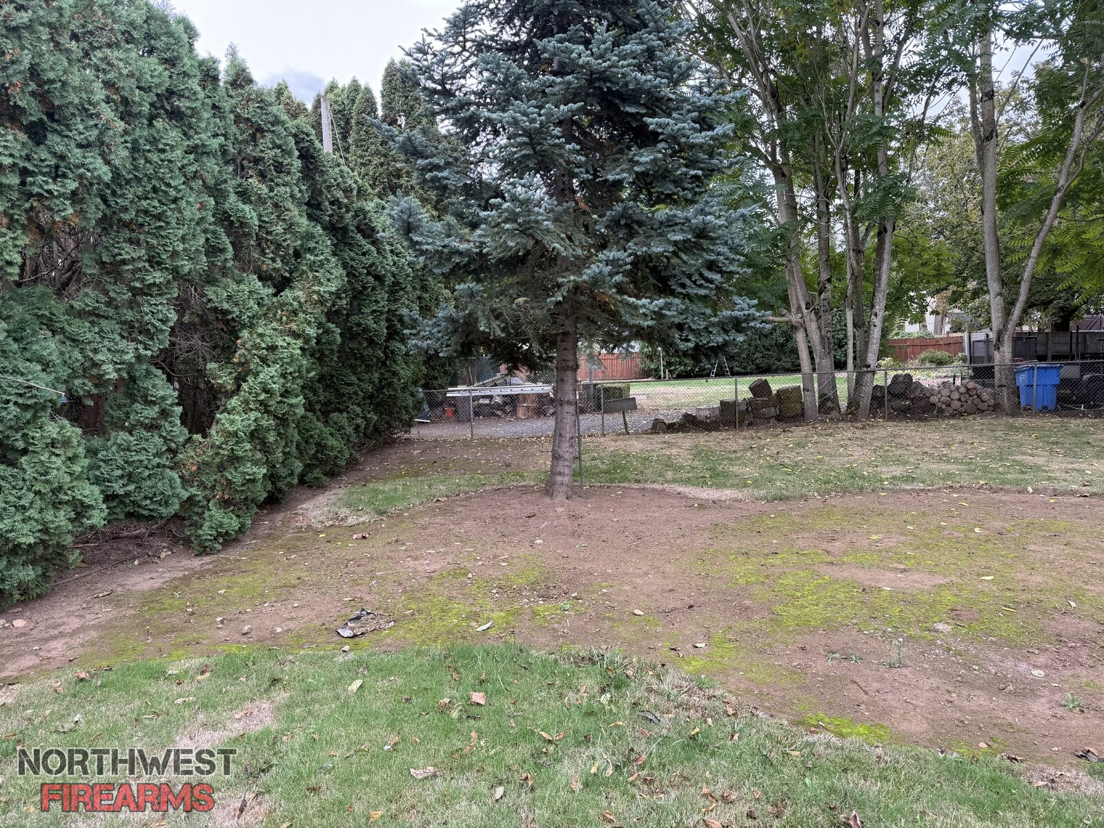

I want to put a shed on this bare spot.
What should I do before I place the shed to keep grass and weeds down?
Likely a Tuff Shed on blocks.
There used to be an evergreen bush there that I greatly disliked so we pulled it out. It stays mostly bare with moss, weeds and some grass popping up but we keep up with that, but won't be able to once we put the shed over it.
Roundup will kill anything green. I would "think" that once the shed is there nothing else will grow since it will not get any sunlight.
If it's enclosed just put the shed on top and spray it with Round Up 365. It will kill what's there and then the shed will keep it dead.
Unless you put grow lights in there to start seedlings.
I have two large sheds. Built them on top of the existing grass. With no sun and no water reaching underneath the sheds, the grass dies quickly to never regrow.
And although a vapor barrier could be beneficial, I didn't use one and I have no moisture issues whatsoever in my sheds.
I perched a 10x16' Tuff Shed over healthy grass without treating anything. Nothing but bare dirt under there now.

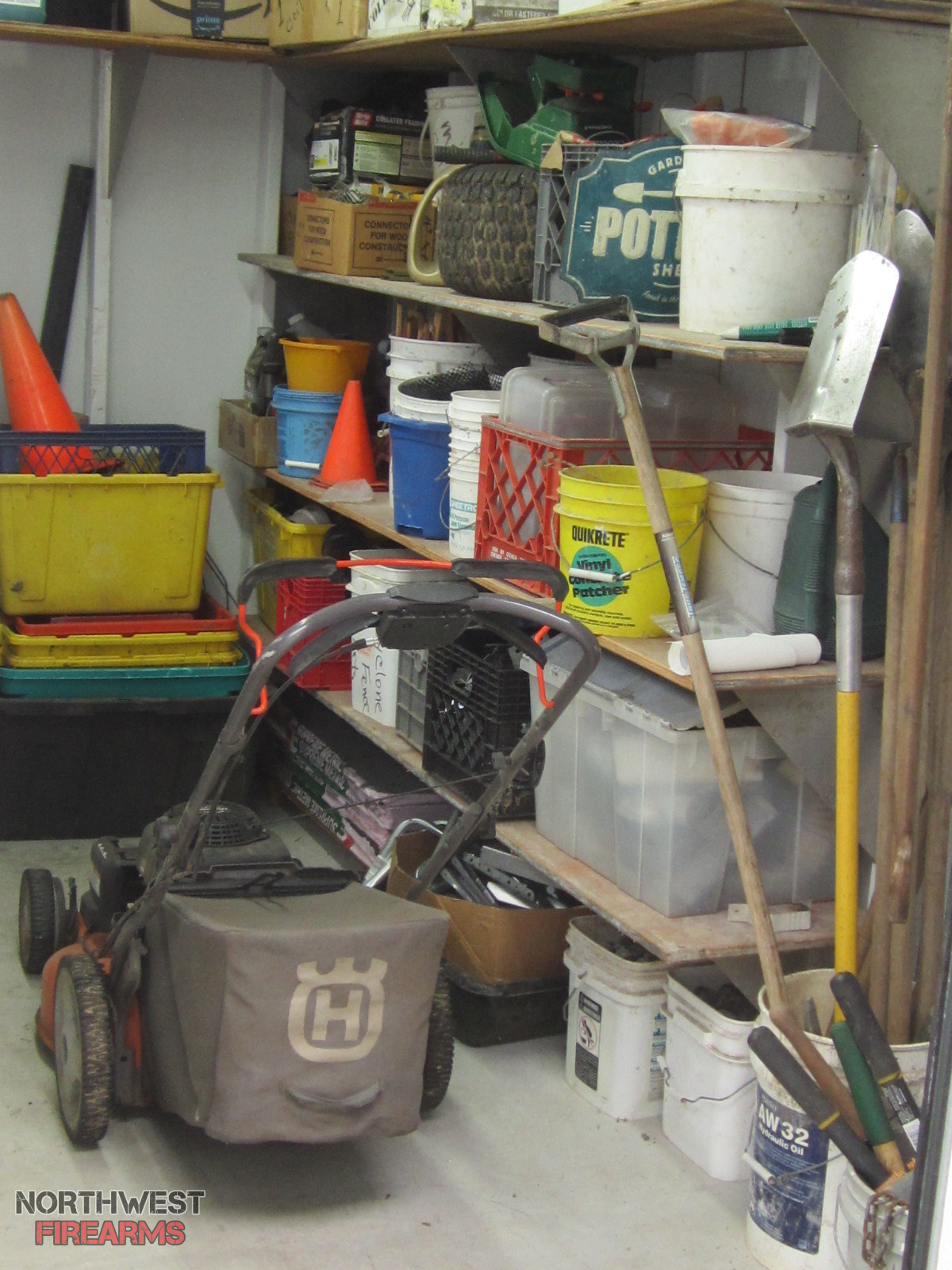

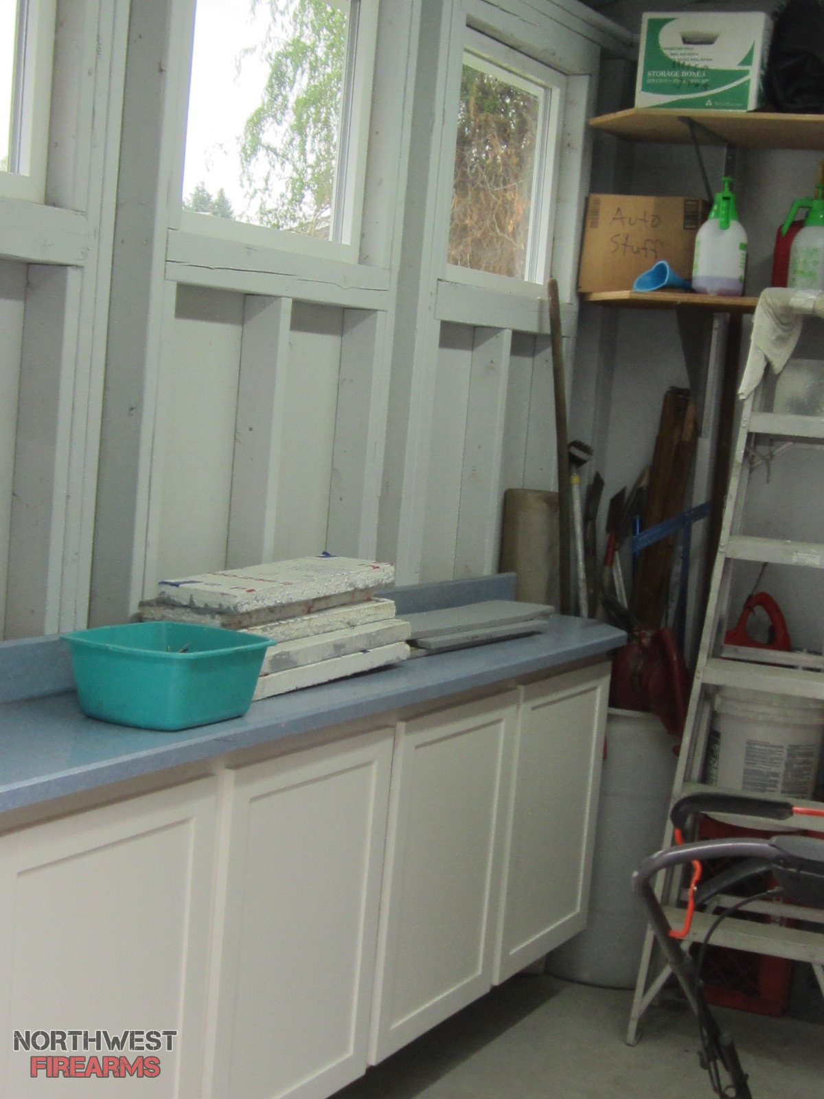

Here's some pics of the custom shed I built this last summer for my rental house.
The 8' x 12" concrete pad along with the 24' long sidewalk cost $520.00 and that was delivered with a special 2 yards mini mixing trailer that delivers to your work site.
The new 42" wide roll up door (which I think is the best way to go for total floor space usability ) was only $125 On Facebook Marketplace and all the other materials I found on Craigslist and Offer Up.
I started collecting all the building materials last winter and the whole project only set me back $1,590.00.
This new shed replaced a piece of junk Home Depot Tuff Shed kit, that rotted from the top down because the previous owner didn't know how to stagger the 3 tab roofing and lined up all the shingles one on top of each other.
