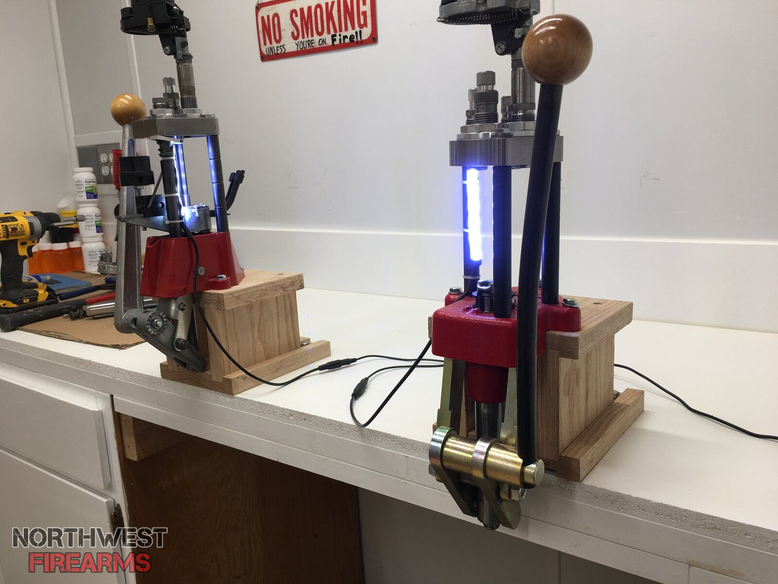

I put some T slots in my counter top and then use 3/4" plywood for the individual bases. This way I'm don't have to mount any one component in the same place each time. The only problem I've had is it's a bit difficult to clean up spilled powder.
I would cut some slats to fit snugly in the T-Slots, I saw a link for them somewhere...

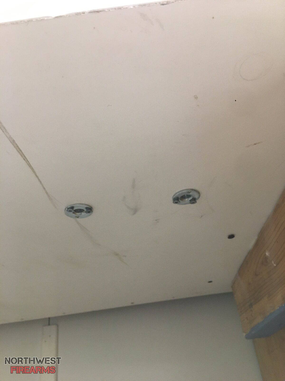

I have the item you should get from Inline Fab, I did not overlap the plate on my benchtop, I moved it in 3/4" because I foresaw accidental hip damage from it sticking out..:D
This is what I did to get at the quick access nuts (the reason for overlapping the plate on the bench top.) ;)
I drilled three-quarter inch holes with a spade bit to access the hold downs at the front of the plate. I use 2" long 1/4" connector nuts with my impact drill to tighten them snugly.
This is how I mounted my press with Inline Fabrication mount to my bench!
