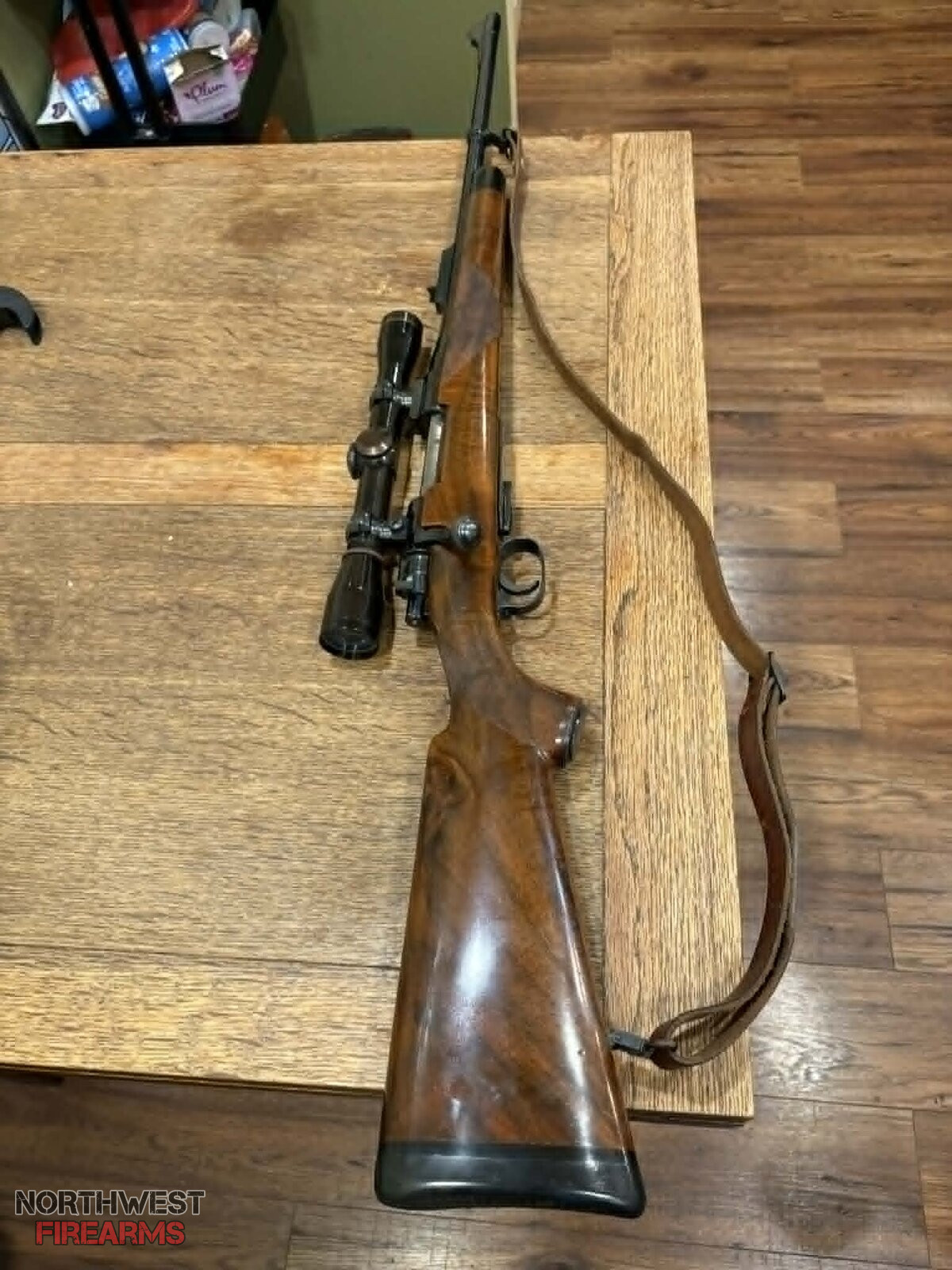

Hi, all, I recently picked this Remington made 1903 at the LGS. It has a two-position safety, Fajen stock, and has obviously had the sights milled off. The action is tight, and it has a decent original two-stage trigger. I have a Leupold 2x7 new in the box ready for mounting. The plan is to...
