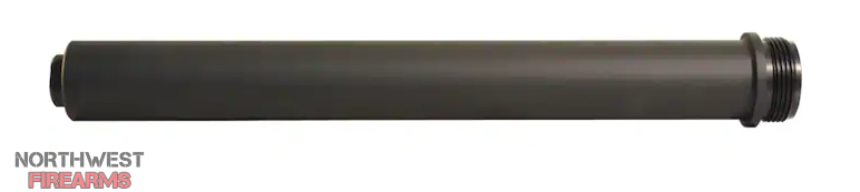

I am tempted to acquire one of the wood stocks like shown in @Reno post in #3. Thinking that and the dedicated can that is currently pending as silencing tool/foregrip would make this a handy little zipper of setup. Think I need a buffer tube like this:
This work, yes? Other parts needed? Thank you, friends. :)

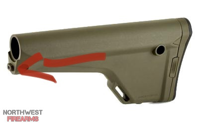

The adapter you have will not work with an AR rifle stock. Just carbine style.
AR rifle stocks interface with the little nub in the lower receiver as well as holds the rear takedown pin detent and spring in place.
If you don't have an adapter like the one I posted in the same post that has the little tab for a rifle stock the stock can rotate on the tube and the bottoms portion would be stock out.
