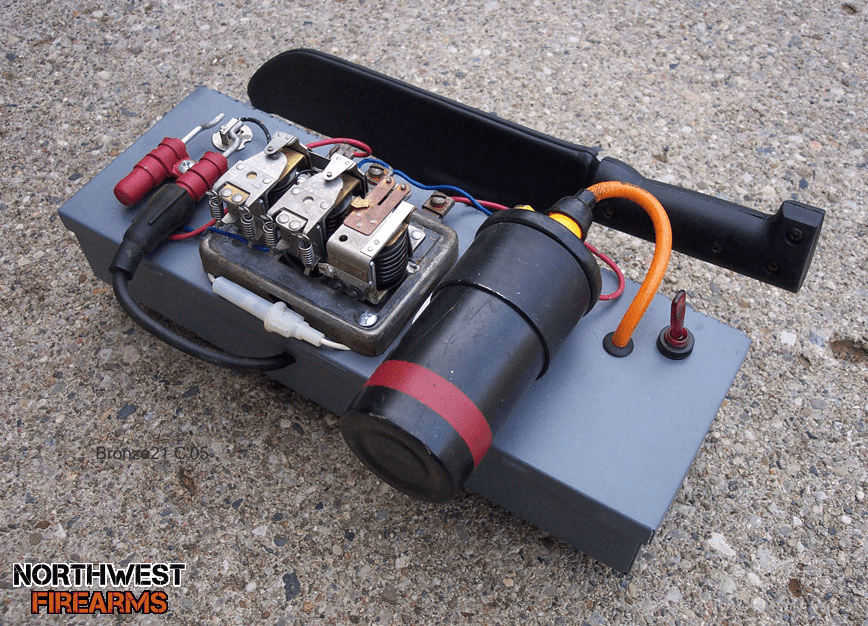

I'd put the switch into something like this: Mad Max Booby Trap Switch :s0087:
