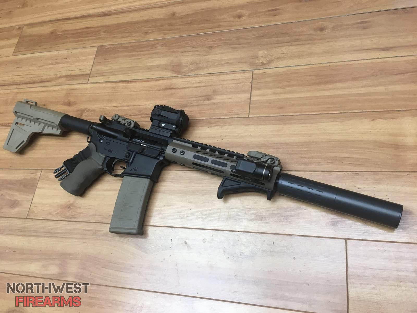

for my suppressed 300blk pistol,i run a 10" ballistic advantage barrel with pistol gas system(i think this length gas sys. is key for suppressed use as i have had not one problem so far) a spikes t2 buffer, standard carbine spring in a KAK pistol tube with shockwave blade... you dont NEED an adj gas block or special BCG a standard milspec one is fine(i prefer black nitride)

I bought a Rainer Arms 10.5 barrel and have an AAC 762 SDN-6 suppressor attached to it.
I didn't buy a JP silent spring, just sprayed a bunch of Loktight nickle anti-seize down the buffer tube.
I did buy one of those charging handles that prevents blow back to your face.
It's wicked quiet and the anti-sieze works as you don't hear anything from the buffer, but it will be a big mess if I ever have to clean it out.
I went a little overboard with the butt stock (Ace Socom M4), it's hell for stout but on the flip side it does help balance the rifle with the AAC can hanging out front, but on the downside it does add to the overall weight.
