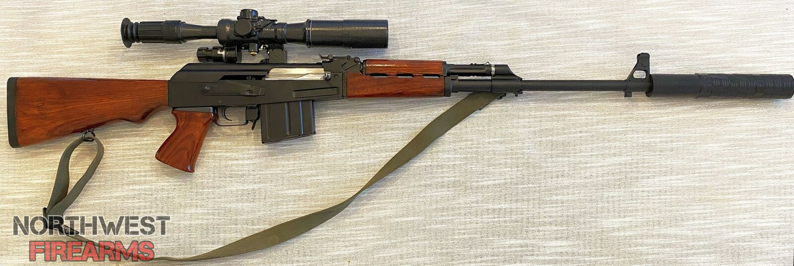

This was more work than it looks like it should be. The silencer that is. I had an existing modular 30 cal silencer that is actually one of my better performing cans. Set up like a SIG or Q can with half cut baffles. Anyway I had to make a ASR thread spec adapter and cut two of the baffles to act as mid supports on the end of the flash suppressor. Luckily I had a couple of extra baffles and when I form 1'd the can I put it on paper out to 14" so I had a little room to work with. Turned out pretty good. Should soak up the 30-06 stuff well. I had to do all this because the front sight and flash suppressor are one piece with 23mm left hand metric acme threads at the base. Weird.
The originals were 8mm Mauser but they weren't really 8mm Mauser, Theyre were set up for PPU Serbian 8mm which is WAY shorter than German 8m. German 8mm will not fit in the mags. I set it up for 3.200" loaded 30.06. Machined the chambers with slightly short throats to accommodate.

So I didn't have any 30.06 ammo because I haven't owned a 30.06 in in 30+ years. . Ordered up some Lee dies which, like most lee products, ended up being crap. Bullets falling through the sized neck. Back to amazon they went. I had 80 Hornady whitetail loads I had to resize for the mags. One of these days days I'll be able to shoot the thing.
