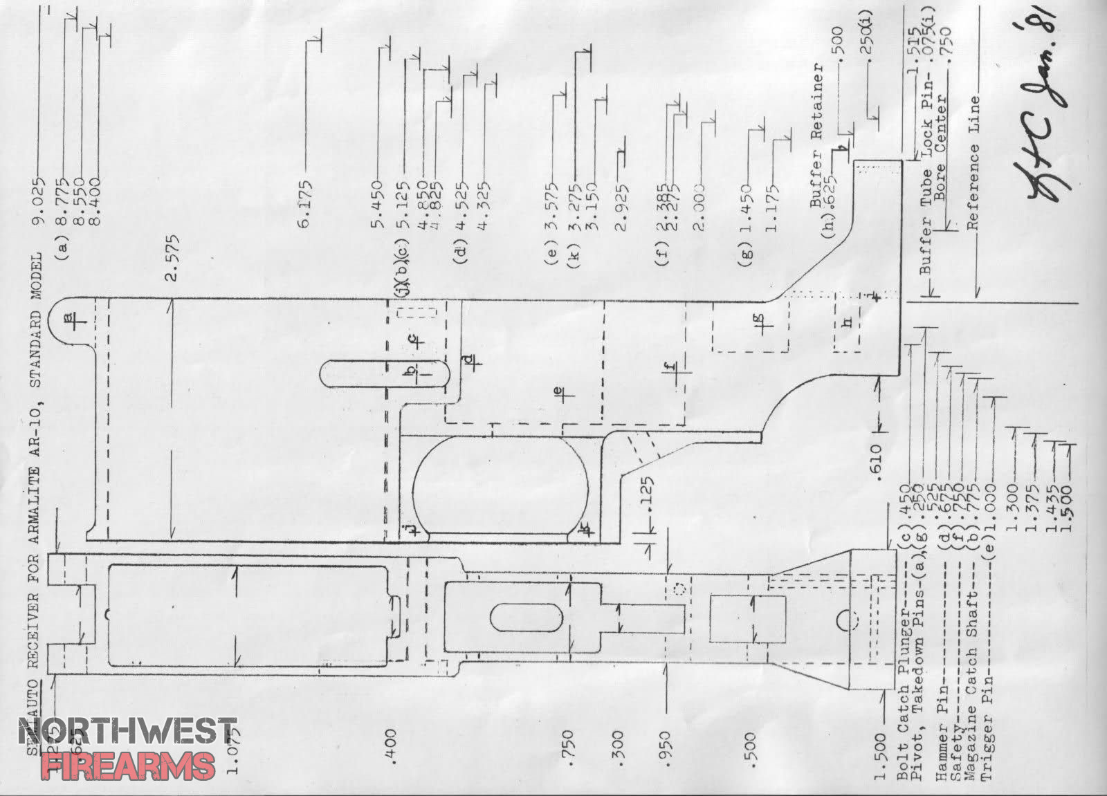

here is one print i have that may help you check your lower.
So assuming (b) is .250" wide (like the dpms patterns), then the dim. From the reference line (.775") which is the "deck" would be .650" which is kinda close.
Im fairly certain though these two the DPMS and AR10 use different pattern magazines. And therefore camlnt be used directly. But its nice to know for comparison. Nice print. I like it either way.
