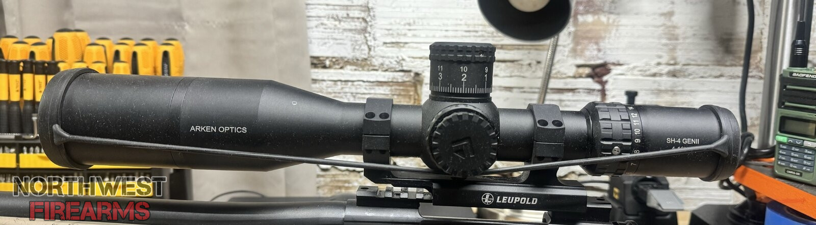

Of these 2, both are brands recommended and her in classified, which would be a better option.

I have the Arken on my AR10.
While it is a great scope for the money I would pick the SWFA 3-15.
Since it's a .308 you don't really need a cantilever scope
Plenty of room up top for a set of rings which is quite a bit less money for good ones than a one piece.

You don't need high rings to clear the objective.
I had a 1.5" tall mount on mine.
And it doesn't add 2 pounds, with the mount it's 3 pounds.
I run it with a 1.93" tall mount now with no cheek riser.
I use a QD mount and swap it with a red dot on a 1.8" QD mount.
If I really wanted to go light with it I would use my NF 2.5-10x42 on it, also on a 1.93" mount.
Compact and light, with the mount it's 27 oz.

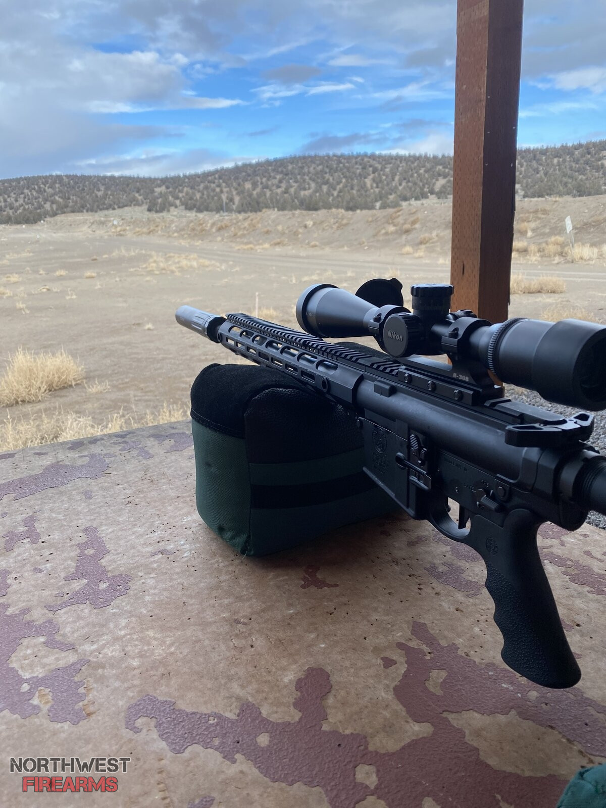

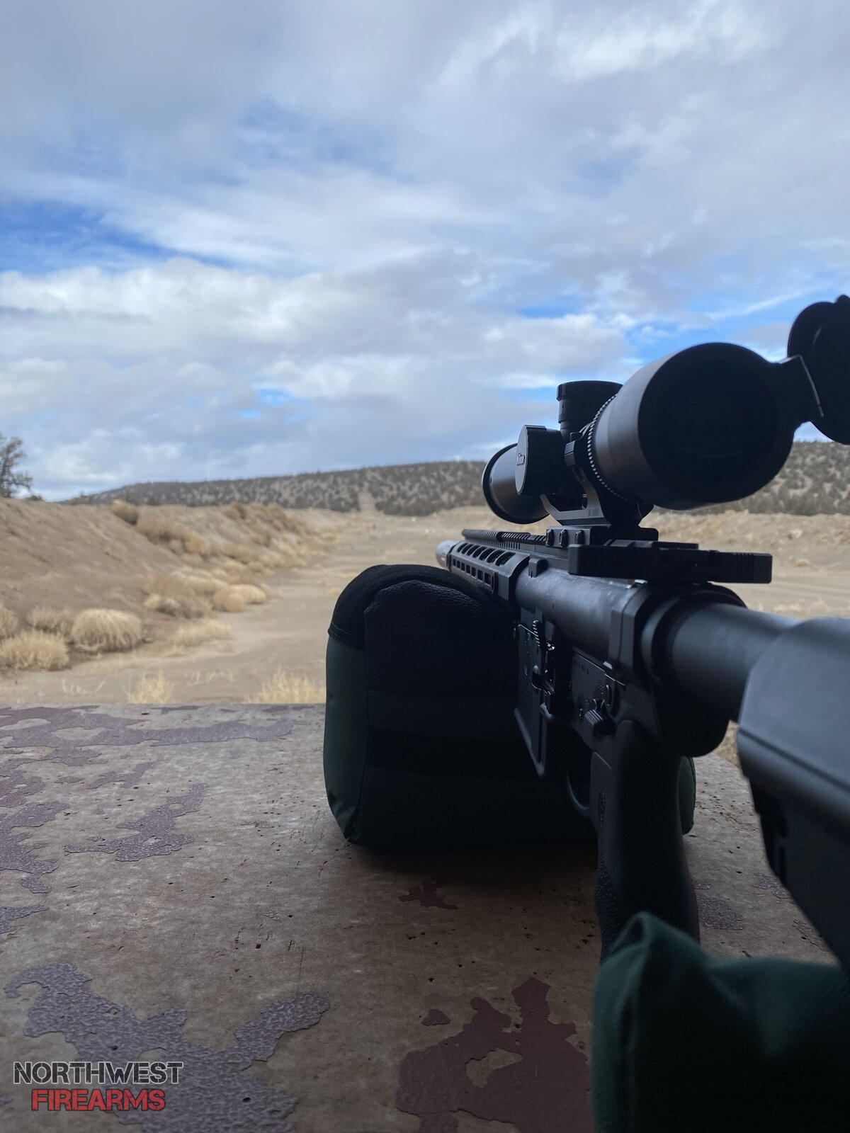

Back and forth between a few scopes. Ended up with original selection Nikon M-308 4-16 BDC w 20 MOA M-308 base and 168gr Fed SMK. 18" M&P 10 zeroed at a hundy- work up and down the range from 600 with BDC easy peasy. Gets a little weird after 600 imo with dem 168s. Wanna stretch it out a little more you can run a 175/185 and make 7/8s a little more consistent. But man fun as hell all day long with a BDC working the range quickly
