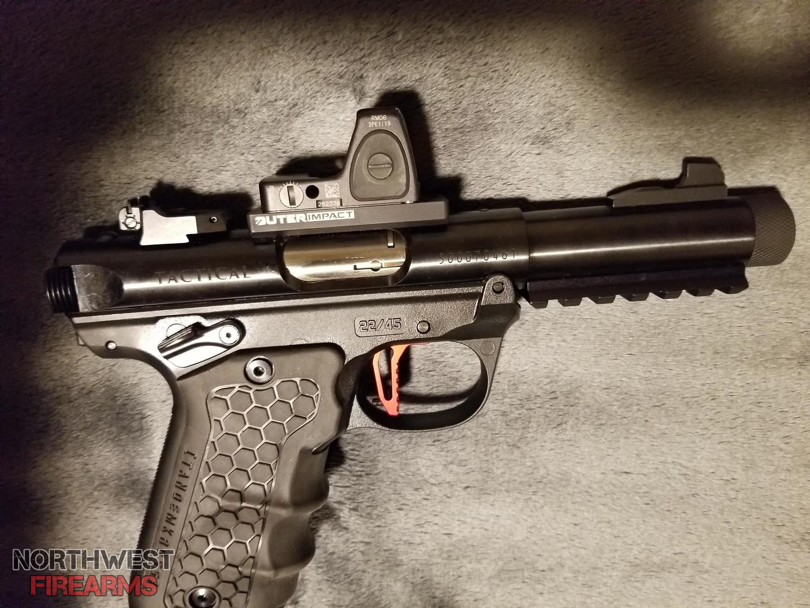

Nice build! Burris make the dovetail mount you're looking for. About $50. The red dot mount screws should fit the Holosun. It fits a Vortex Venom perfectly.

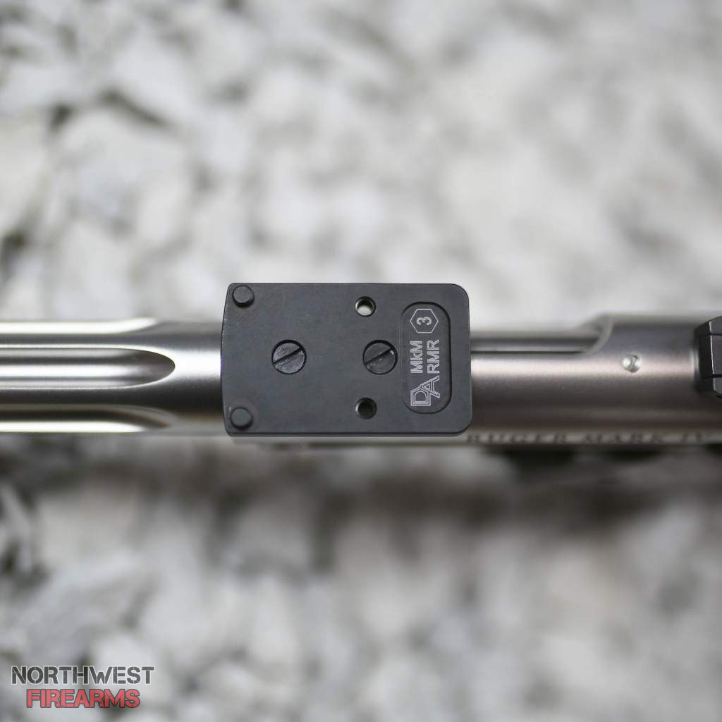

I looked at the dovetail mount, and the out impact. I wanted something more forward mounted. Then I found the Definitive Arms mount. They are also the ones that make the little buffer tube adapter for the ruger charger.
Anyways this mount is supposedly lower to the bore and mounts using the most forward two screw holes.

The mount I purchased is this one. I misspoke and put primitive arms. The brand is definitive arms. Through copper customs.
Copper Custom Armament

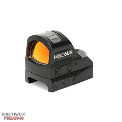

I also purchased the Holosun 507c to use with this mount. I got it off Amazon as most others have it out of stock. It uses Trijicon RMR bases. So it will work fine with the Definitive Arms base. Even Amazon is out of stock currently.
