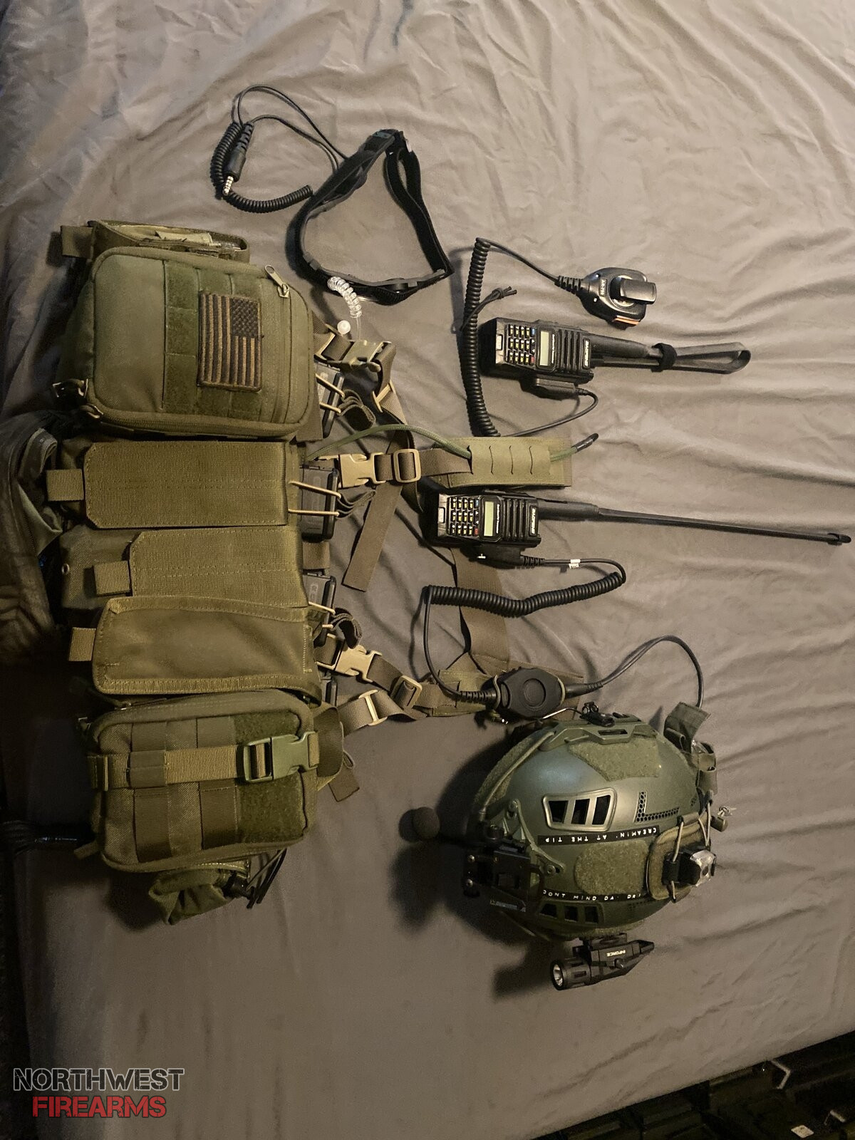

For normal day-to-day operations on the ranch, I have ten 5 watt GMRS handhelds, two 40 watt GMRS mobiles, and another 40 watt GMRS mobile set up as a base station in the office. For SHTF, I have stored an identical setup wrapped in Faraday cloth and stored in a grounded Faraday cage/locker.
I didnt go doomsday or super high speed level with manpacks and encrypted comms and atac and stuff, but better than the 99%.
  • 6-8 Retevis ham radios, no screens, 16 channels, to hand out to neighbors, preprogrammed
  • 8-12 Retevis RT85 for group comms, preprogrammed with ham and gmrs repeaters and channels
  • Anytone base station (mobile), retevis base station, and retevis 10w repeater which we will be setting up in Longview within next couple of months (outdoor antenna and whatnot) for gmrs
  • 7 Ailunce HD1 DMR radios for digital and encryption and sms/text capability
  • Various disco32 ptt gear, antenna relocation and pc/chest rig antennas, as well as short stubbys
  • Printed and laminated comms plan in a manilla folder with "OPEN IN SHTF", that also includes other plans like security so we arent figuring that out in the middle of "omg what is happening"
Part of comms plan was to KISS, while also planning for which channels to use for security, local general chat, trading, stuff like that, even if its just a base for a starting point.
