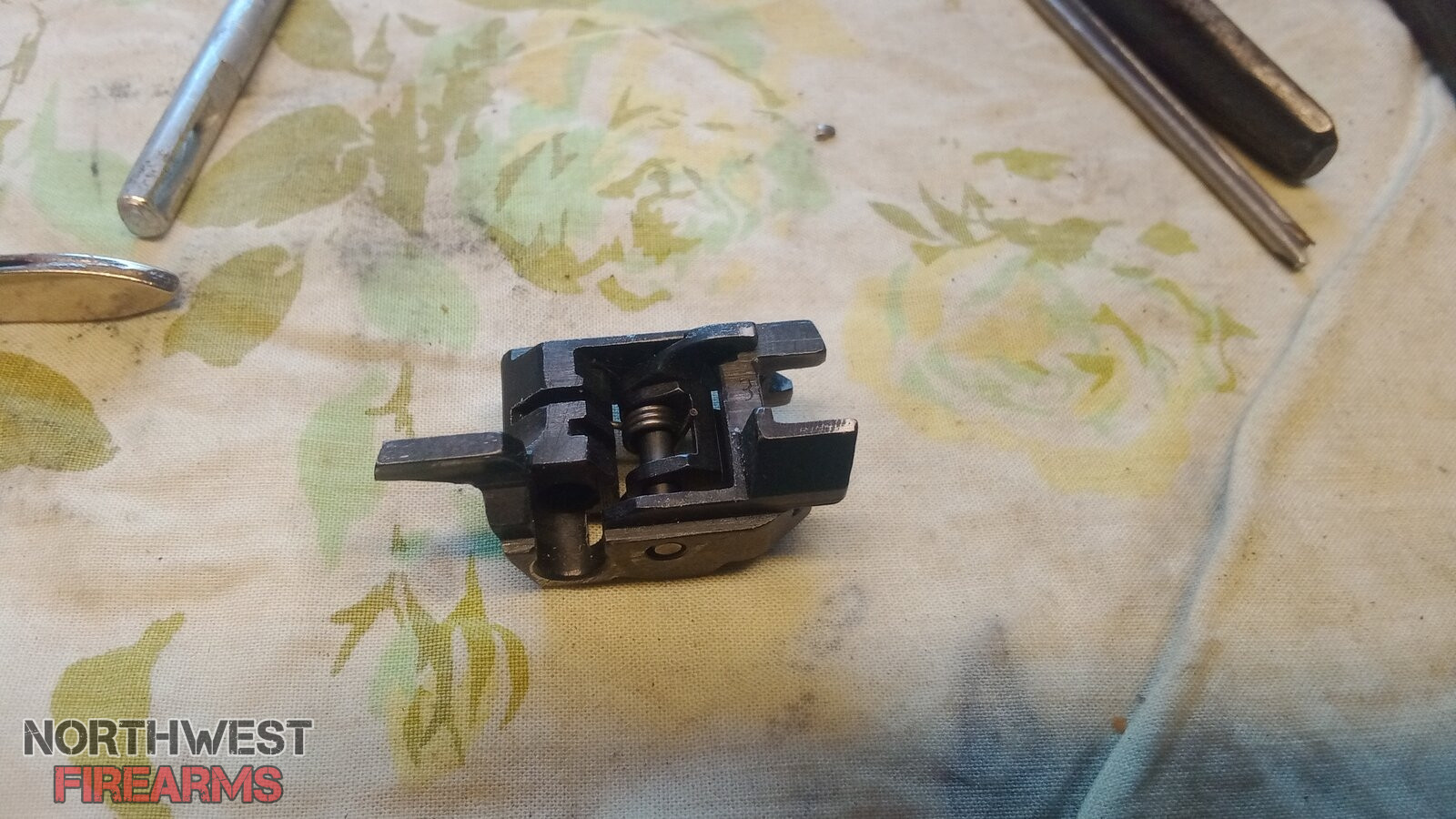

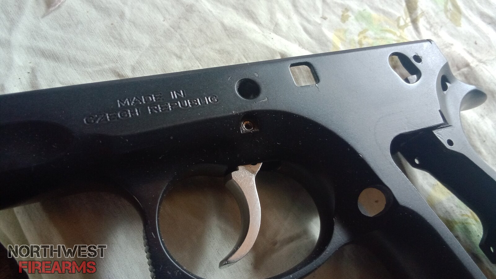

Man, its been a couple years since I completely tore down my CZ 75 BD for a thorough cleaning and I forgot about two of its well known headaches - one being the sear cage removal and disassembly and the trigger pin removal!
The trigger pin is hollow partially on both ends and needs a punch small enough to enter it and punch it out without expanding it.
Well, I custom made a punch for this and got it out with NO damage and I am considering either ordering an aftermarket floating trigger pin or trying to turn one on my lathe Small work but I might give it a try!
I really like the CZ but it has some really tiny internal parts!

Pretty much all of my steel or aluminum frame CZs based on the 75 series that I have disassembled (which is nearly all of them) have been treated to a Cajun Gun Works floating trigger pin. Much easier in my experience for assembly and disassembly. Making one would work also if you have the equipment. That said, ther are pretty reasonable to buy IIRC; probably cost you almost as much in shipping as the part itself.
And yes, the sear cage on a decocker adds to the fun, for sure! I refresh my memory with a couple youtube videos each time I try to tacke one of them. The safety models are easier, for sure.

Yea I might chuck up a a piece of round stock in the lathe tomorrow and give it a try.
Pretty small work, as it's only .086 in diameter, but its pretty basic so I might be successful!
Yea, word is on a few sites the original trigger pins don't last through more than a couple removals without getting damaged beyond further use - OR frames get damaged from them NOT being properly removed. I saw some pics of this! Ugly!

Yes ditch the trigger pin got a floating one and get some extra springs while you are at it. I believe it is meant to be replaced with a new one when you remove it for sure that's the case with the firing pin retainer.

Question - so does the floating trigger pin install with hand pressure and stay relatively 'free' - or is it still a little 'snug' in the hole?

It's reasonably snug but you can push it out with hand pressure and a punch. The main retention is achieved through the trigger return spring I believe. Almost every competitive CZ shooter uses them and the pin failing in some way is pretty rare. That is with very high round counts and hard use.
