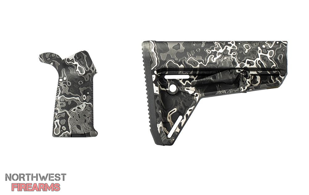

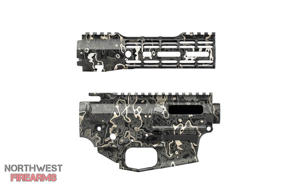

Yea, that's what I got. Couldn't resist. I've got a full length of that rail and really like it - not having the rail go all the way makes for a very comfy rail.
I'm not normally the kind of guy to worry about matching my shoes with my belt, but couldn't pass these up when I saw them for this build either:

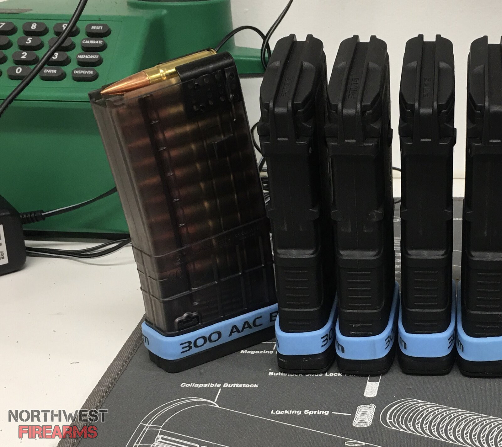

IMO the only drawback is that 300 BO will chamber in 5.56 followed immediately by disaster and since it uses 5.56 mags you need to be very careful not to get them mixed up. I strongly suggest you find a way to keep them straight like one or more of these among others:
  • A different color mag used only by 300BO. Example: Black for 5.56 and FDE/Coyote for 300 BO
  • Use plastic for one and metal for the other
  • One distinctive brand used only for 300 BO. Example: Magpul for 5.56 and Lancer for 300 BO

Thanks for the mention brother @3MTA3 as I forgot to include this very important fact in my unusually short post.

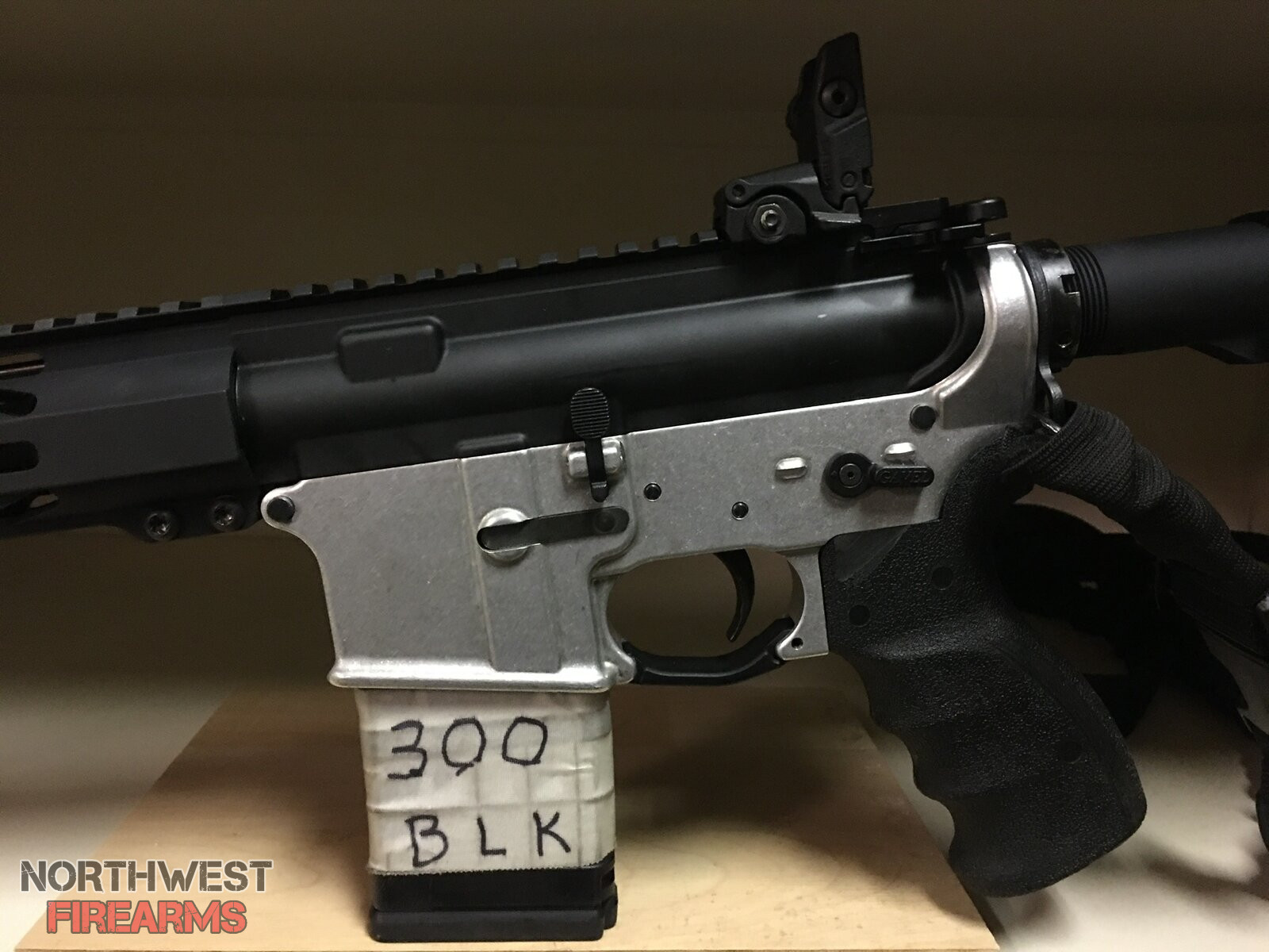

I used to use white fabric medical tape on my 300BLK magazines but found a great deal on some rubber magazine labels.
At the onset of the 300 black build I made the decision to use only polymer (lancer & Magpul) 20 round magazines and US G.I. 30 rounders for my 5.56 AR's.
