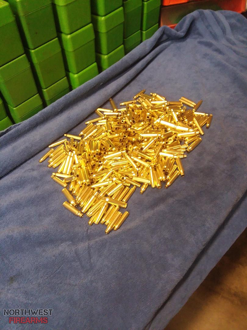

Nosler prepped 223 cases. FWIW, these things rival the best brass I have ever seen. They weigh the nearly the same. They are the same length. They are ROUND without the lumps and bumps so common in many brands. Two thumbs up, only because I don't have more thumbs. If all of Nosler brass is this good (The only other Nosler brass I have worked with is 270 stuff. It's very good as well) Lapua had better look out.
