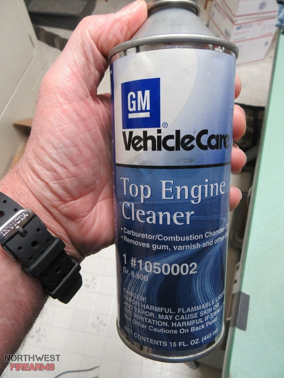

The Best ...
Just be careful with it. Highly flammable and toxic... exposure runs the risk of kidney, liver, nervous system issues, brain damage.. and chemicals known to cause cancer.
But it works, so I hear, and used by many. POTENT stuff.👍
yep always wear gloves when dumping it on a patch or brush.. there is a reason why they discontinued production of it . but it melts carbon like butter .
I got a couple cans that will last past my lifetime. the stuff is top dog if you have a hard as diamonds carbon ring .
