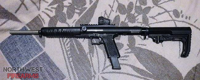

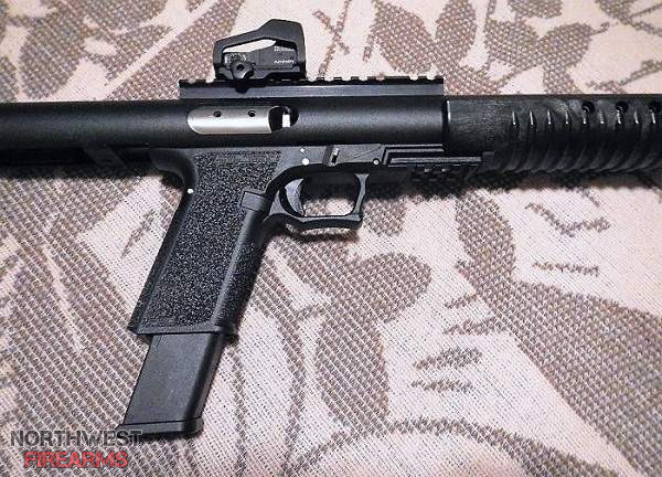

So... yes! The Polymer80 full size works like a charm on the CCU's... with very slight modification.
The only thing that needed to be done was to file back the thickness on the forward polymer locking block guides. I ended up having to take them back to almost dead on half thickness to get the CCU latch to engage the slide lock, but in no way affects the performance of the lower.
Worth noting: The poly80 guides are twice as thick as an actual Glocks so, in affect, filing them down just put them on par with the glock's guides.
I left it quite tight so it takes quite a bit of pressure to release the lower, but it was my intention to leave it attached so "tight" is good.
I put 74rnds through the CCU (2x22rnd, 2x15rnd) and ran flawlessly. I then put the G22 slide on it and ran 4-15's through that to ensure the mod hadn't affected performance. We're all good!
I had stuck the burris FF III on it and it's quite a hoot to shoot. It's most defiantely going to need a riser if I keep the reflex sight on it, but I couldn't wait until it came in to throw a few out of it.
Great fun, that! ;-)

Exactly! In all fairness... "out of the box" they don't. The thicker polymer at the head of the block doesn't affect a standard slide in the least but it's just a hair too thick to fit into the mounting assembly stop of the CCU. Cutting/filing it back to the same forward rail length of an OEM glock lower though... fit's like a glove!
Pretty minor mod considering the cutting/milling you already put into the 80 lower.
