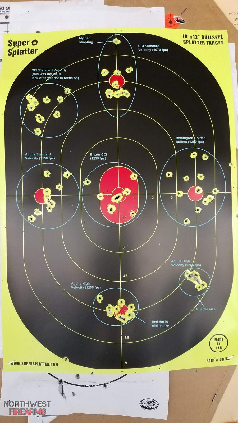

This past week, I cleaned the barrel 2X using Breakfree, and 3X using Hoppes No. 9 after letting each soak. Return cotton flannel swabs only oily. Ok, I think it's clean, dang it :)
Took her out yesterday. Loaded 10 rounds of Federal 36GR CPHP (1260 fps). Set rifle on Caldwell rest, and put crosshair on target center at 50 yards. Pulled trigger. Zing. Missed center by at least 6 inches. Pulled trigger again. Zing. Closer to center but still way off. Blam. Blam. Blam. All 10 hit within a 6-inch group. Fugly. Ok, time to retire this firearm. Throw-away target not worthy of a digital photo.
Wait, I just received several bricks of CCI Standard Velocity (1070 fps) Monday. Loaded 10 bullets. Pulled the trigger on round one. Hit. Pulled trigger again. Hit. WTF? Dead on at 12 o'clock! (except one shot that I yanked).
Fully confident rifle is fixed, lemme try me some Golden Bullets (3 o'clock). Zing. Blam. Blam. Blam. GB sucked.
Now let me try some Aguila Standard Velocity (9 o'clock; 1130 fps). Hey, not bad.
Ok, I have some Aguila High Velocity (1255 fps), I can't imagine those will do well since it appears the rifle likes the lower velocity.
Holy schnike (6 o'clock)!
I don't believe that. Lemme try again. OMFG (4:30).
Well heck, I have some Blazer and it's similar velocity at 1235 fps. A couple of double taps; the rest me due to excitement (center) and impatience with previous results.
Since I have CCI remaining, lemme see if I can repeat 12 o'clock results. My bad shooting; I was completely impatient and only had an imaginery target point.
Long story short... clean your gun; test various ammo types to see what it likes; and then hoard what it likes when there's a sale!
Thanks, All, for the help/suggestions!

Sounds like it's on the right track. ALL .22's will have some ammo they like better than another. Even the same model bought the at the same time. Normally not that bad but they all have some they like best. At least it's getting there. I would get some lead remover cleaner and go at it carefully with that at least one time too. Not real common for these to lead up but it can happen. Normal cleaners like Breakfree are not really made for this. Will not cost much to buy some and give it a try. Let some soak a while then run a patch, see if it comes out discolored from bringing lead out. If it does, repeat this until it stops then try it again. Hopefully you will be good with most any ammo.
@RaceFan what was your point of aim for the Aguila that's bottom right on target?
I'm glad you tried different ammo!
Mine also likes the Aguila HV orange box stuff (super extra). The blue box Aguila, not so much in any of my rifles.
Now if you want to really experiment, try some 1500fps and 1900fps CCI coppers. I can't recall the exact name right now but they are good for about 0-25y then they get a little wild.

22's are dirty to start with, one sitting that long is bound to have lead built up in the barrel.
I've taken old Marlin 60's that were neglected and they shoot as straight as the one I bought myself on my 18th birthday after a thorough cleaning.

I was aiming for the 6 ring at about 4:30. Once I made impact, I tried to hold the crosshair at that bullethole.
I'm going to start hoarding Aguila HV (orange box) for this rifle. I've been collecting the SV (blue/silver box) as the Ruger Mark IV does very well with it.

Since the first two "deep" cleaning, I've stripped and cleaned again twice. I even ran a bore snake through about 20X the last event as a final step.
The Marlin has been shooting like a champ. But it IS picky with ammo.
Mine likes Aguila High Velocity [orange box] and makes smaller than quarter size groups at 50 yards. I'm usually the fudge factor. After that, it's a wash between CCI Standard Velocity and CCI Blazer. I've learned the rifle only makes a bang noise with Golden Bullets and Federal CPHP as that's all it's worth :p
