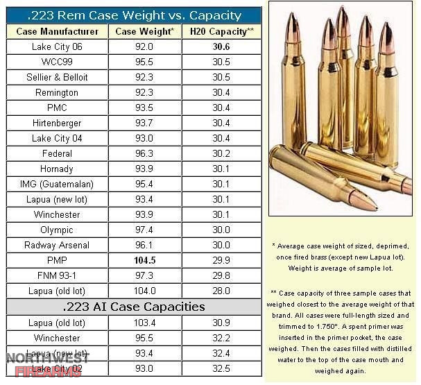

Almost 10% variance in weight/capacity. Loose primers, yes! Over-pressure. Flattened primers, the same. Extruded primers, ejector dents - you nailed it. Loads are not just warm, but hot and too hot.

Perhaps mild in your other cases is not mild in Norma if they're thicker with less case capacity.
