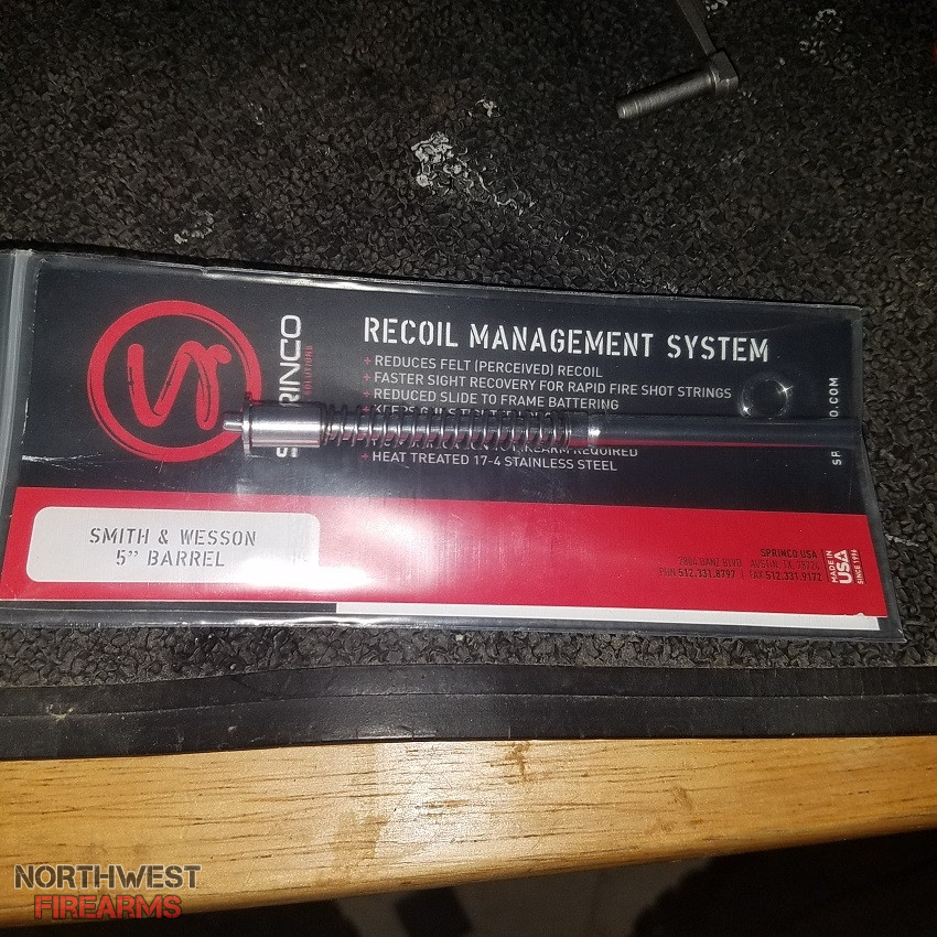

the recoil management system is on order
they are using a 3rd gen Smith 45 guide rod and put in a 45 Super spring
will send photos during assembly

the reason the HK45 is rated for 45 Super is the HK recoil control system
with the Smith 4506, I just over sprung it
with the Sprinco recoil management system, I'm hoping to come closer to the HK control systems
the 45 Super is still lower pressure than the 10mm, so I have no fear of frame damage on this pistol
but the recoil is aggressive with just a 20# spring
also thinking of a Wolff variable recoil spring in the 17.5# range

installed the Sprinco Recoil Management System today
the little washer is the slide bushing - aligns the guide rod and activates the 2nd stage buffer
had a 4506 spring tuning pack from Wolf
decided on 18# spring for 45 Super, as compared to 14# for 45 ACP
good recoil control with 185 gn Underwood 45 Super
still shoots 45ACP for practice, but will shoot 45 Super if I encounter dangerous game - or Big Foot

in the end:
20# hammer spring
18# recoil spring
factory firing pin spring
