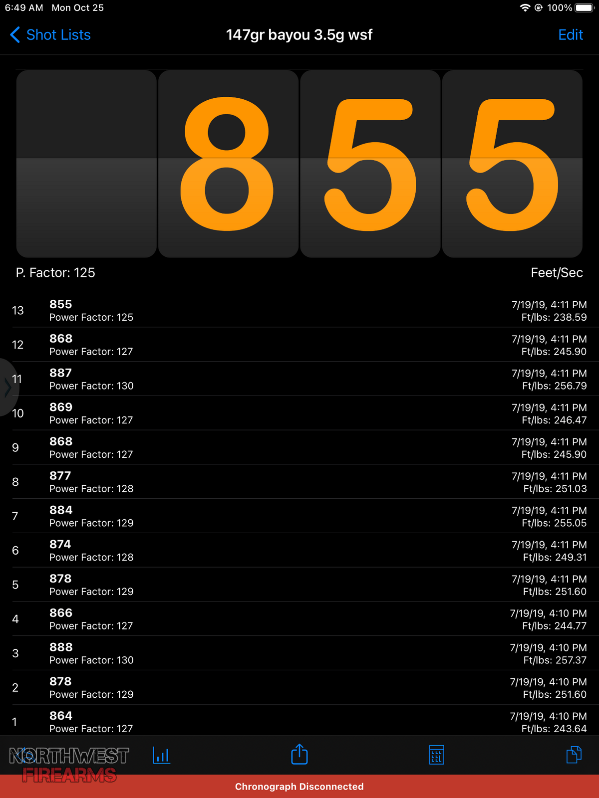

I have a some Missouri coated 9mm 147gr bullets and I can't find very much load data for them.
These are cast bullets (about 18bn) and nicely coated. I found a little data, but mostly using WST which I don't have.
Has anyone worked up a load using these bullets with 231, WSF, or AutoComp? I'm looking for a starting point for a competition load.
Just use lead 147gr bullet data. If it is used for competition that limits lower velocity, load for a velocity target then confirm acceptable accuracy.
My 147gr Bear Creek Bullet load uses AA5. I like slower powders for the bigger bullets. While it does not get a complete burn, recoil impulse feels softer and it burns really clean. I have also used CFE pistol with similar results.
I use Missouri's coated bullets and use 3.4 gr of W231 which seems to chrono out at 830 fps for me.
Around 3.5 grains of wsf got me at the low end of 130pf with 147grain
