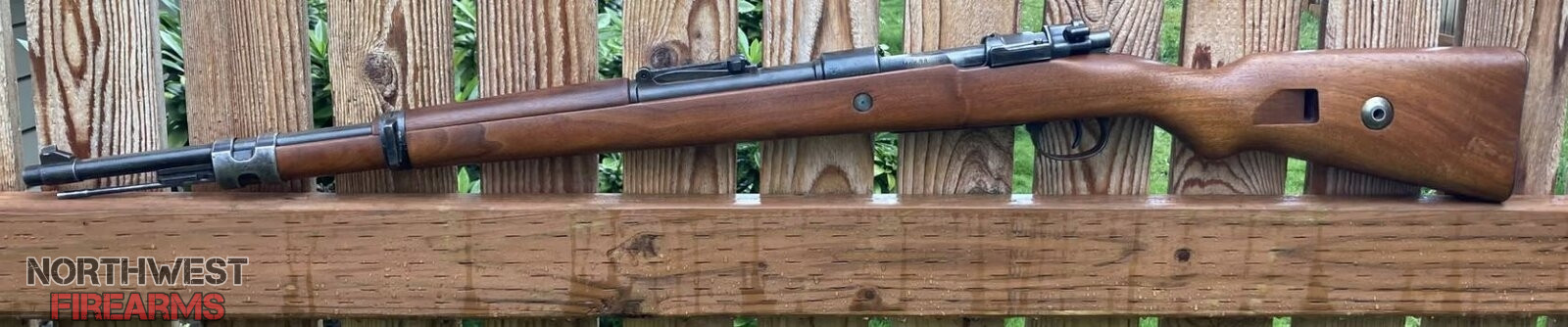

Hello. Looking at s Sauer made k98 that has been somewhat sporterized. It would need the full stock set and hardware and a new rear site as the current one has been modified to remove handguard attachment. How hard of a project is this and where is the best source for wood and parts? Specifically it would need a flat but plate stock set, all hardware and a unmodified rear site installed.

It depends. Using private person to person sales on forums here is what I see.
Russian capture mixmaster rifles are $850+ , you get a matching receiver+barrel. Everything else is likely a mix of other k98k parts.
Romanian capture rifles are usually bolt mismatched and have nazi symbols peened out. Probably $1000+
Matching rifles, $1500+
Decent stock will be $350+, rear sight $100, bands and spring about 50-75. Look at user tagmil on ebay, he has everything you would need. You want WaA37 marked parts for a 39 JPS.
You can reduce the money a little by using a RC stock or a reproduction stock. I used a reproduction walnut stock on my 38 BLM that was a sporter rescue that was barrel+receiver+bolt+trigger guard matching.
Here is a thread with some walnut stocked 37-39 JPS rifles: https://www.k98kforum.com/threads/37-39-jps-gallery.3363/
Thanks for sharing a picture. So purchasing for around $200-300 plus remilitarize cost would still add up to a more valuable rifle than a RC? I guess the unknown is how likely I am to succeed with a good rifle at the end.
What exactly are you getting for that money? Do you have a picture?
Good rifle? How is the bore? That's the main factor in making a good rifle.
I think the base rifle is a good start with all the right markings on it. Its a clean not too hacked up sporterized rifle with the biggest hacks being the site and stock. Bore is not shiny but the rifling is clear. Seems like if I take my time it could be a cool project that would be around $900 if I go down that route.
Yes, if you're starting at $200-$300, sure, you can put together a respectable rifle for less than $900.
So will it be worth around that amount? If I do it I wouldn't plan on getting rid of it.
Yes, around 300 plus minus a few bucks , yes it makes sense . Empire arms just sold a bunch of barreled actions for $250, and that was without a bolt. I'm assuming you have the bolt and the trigger guard and magazine plate and follower, so that's a plus. Make sure you factor in the cost of the work of soldering on a new rear sight .
