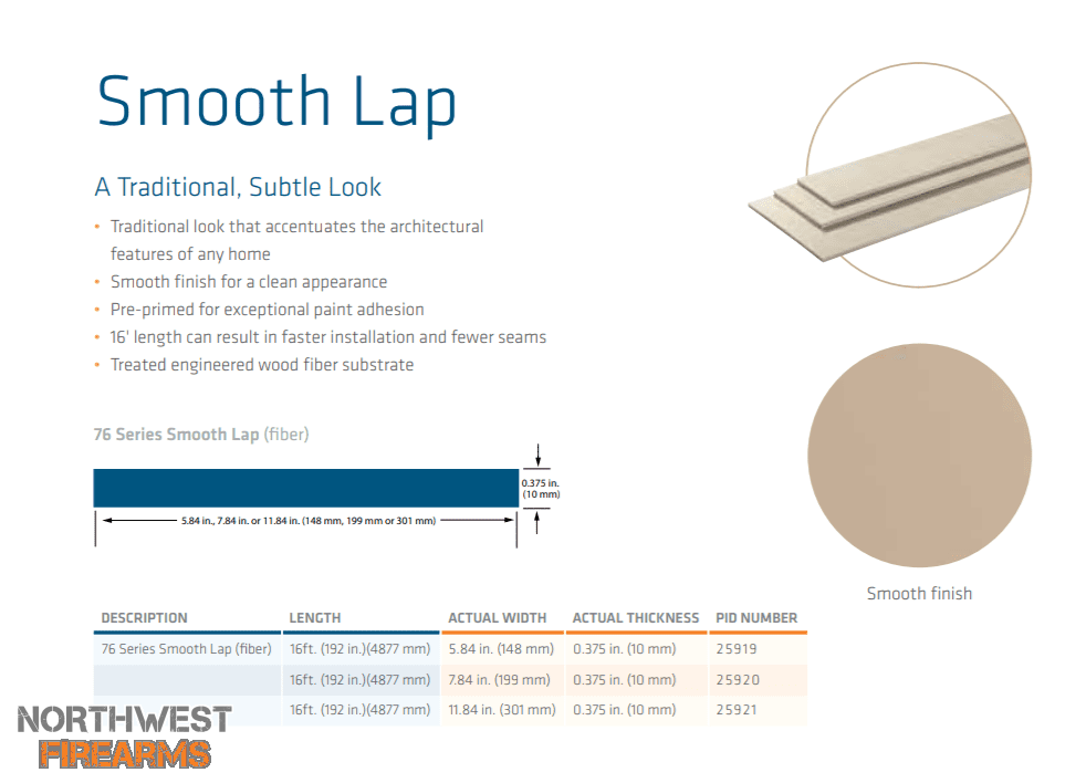

I have seen that siding around. The only thing I am not sure of is the thickness. Would it be noticeable to go from .5 to .375? Assuming you have to run the entire length to avoid the obvious difference where the boards meet. Just not sure if you would be able to tell as your eye scans down. I really only need to redo the bottom 6 boards all the way accross.

The LP 76 Series lap siding is 7/16" thick.
