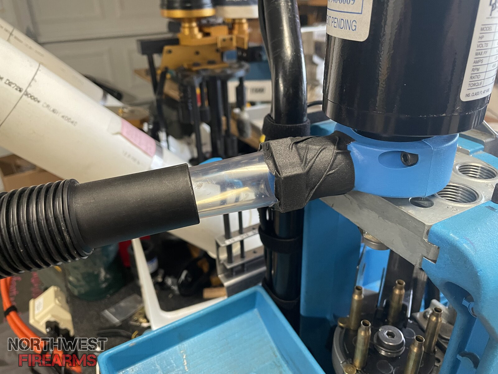

I just got my Dillon case trimmer and my 1 1/4" shop vac hose does not fit over the exhaust. After searching my garage, I discovered the case of my Lee decapper die fits perfectly into the hose. I cut the cone end off and taped the other end to the exhaust. I know a lot of us have these dies so I wanted to share the DIY adapter. I also like seeing the brass shavings getting sucked through the clear part.
Have to take the nozzle off of the end of the hose. A 1-¼" hose is more like 1-3/8" ID.
Four wraps of painters tape and it's snug with hose to adapter.
