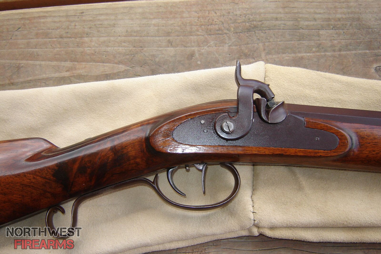

Some percussion guns do not have a clean out screw....or if they do...it can be "frozen" / rusted / stuck in place.
The nipple is a sure bet....:D
( I can't believe I just said that...:D )
Andy

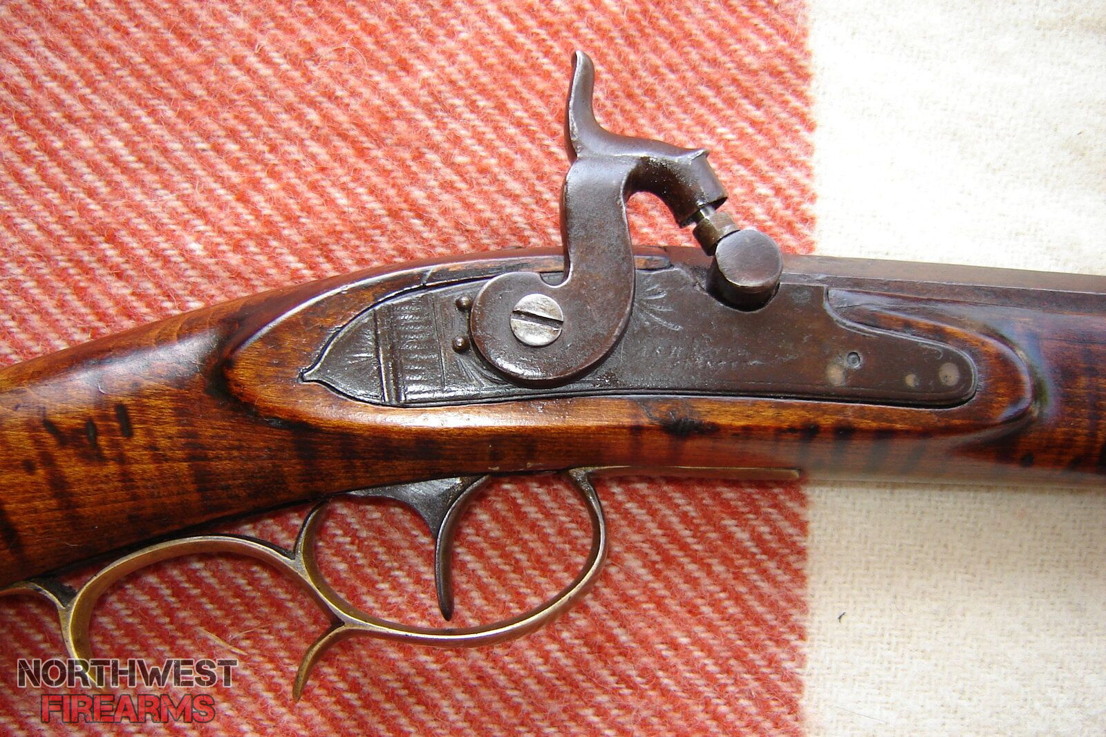

No clean out screw here....
I have been lucky with my flintlocks....and have been able to pull the ball out , after pouring oil down the barrel.
But then , I tend to use a looser than normal patch and ball combo , then most shooters.
I have seen the CO2 dischargers work...that is always a option.
Taking the breech off to drive out the ball is indeed a PITA....:eek:
Andy
