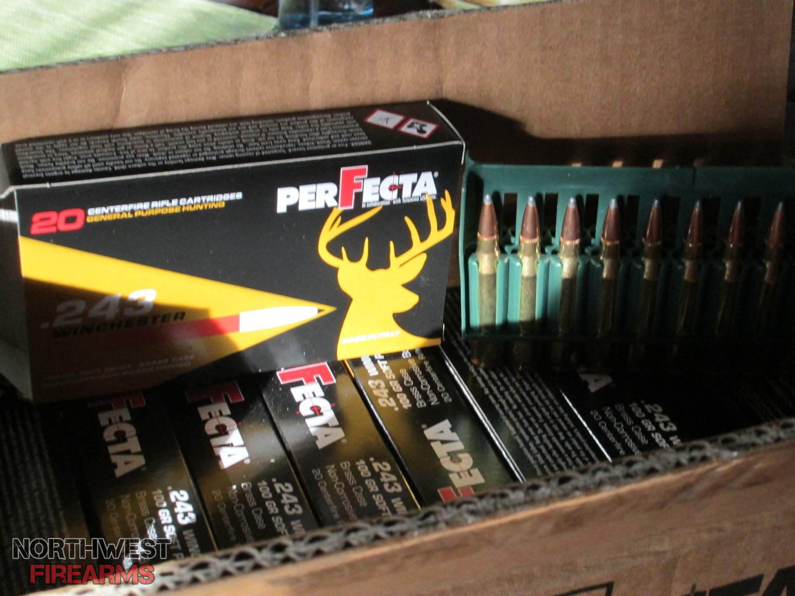

Hey guys thought I would share some info, I bought a case of .243(400 round count) of Fiocchi PerFecta Rifle Ammunition PF243000, 243 Winchester, Soft Point (SP), 100 GR, 3400 fps, 20 Rd - Able Ammo .243, it was pretty cheap 8.50 per 20 round count box. I thought it would good for plinking. this past week end I took 5 boxes with me and headed to my friends farm gun range, i fired 3 rounds then the 4th one would not go all the way forward in the chamber, mmmm ok, i manged to pull it out, it looked ok, reloaded and the same thing happened with the next 8 rounds, after that i wouldn't touch it. When I got home I emailed the place i bought it from Discount Hunting Supplies & Shooting Supplies, Ammunition - Able Ammo. After 2 days I called them, no answer just voice mail, i emailed them 3 more times...nothing. So on a hunch i decided to email or call..fiocchi ammo to see if they could help, and look what i found....Product Warnings and Recalls. recall, ammo possible loaded with double bullets WTF, talk about getting someone injured or even killed. So I emailed them, got a very fast response and the person that is handling all this will be back into the office on Tuesday, and he will take care of my refund or look at replacing the .243 with other ammo product. Ables ammo is still selling this junk on their website, should i contact the ATF...So just beware of ables i have bought from them before however they lost a good customer for sure...stay safe ps...the codes are stamped on the inside of each box, however a lot of them can not be read they look like someone has tampered with them, hhhmmmmmmmmm???????

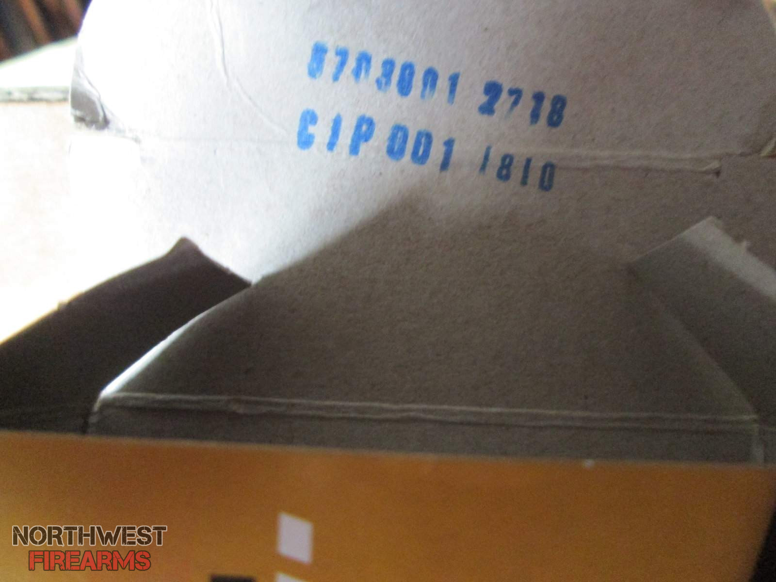

Yeah its all of the perfecta line they list the first 3 numbers 001 all the way to 008, and this stuff is all over the internet, pretty scarey
I'm still not seeing it. The page you linked only mentions Fiocchi, and I don't see the name Perfecta anywhere. Any chance you can point out what I should be looking for?
Also, is there any chance you can take a photo of the product number on one of your ammo boxes for me? Thanks!
No its right there on the top of the page just click the link, and there is a photo of one of the numbers stamped on the inside of the boxes.
