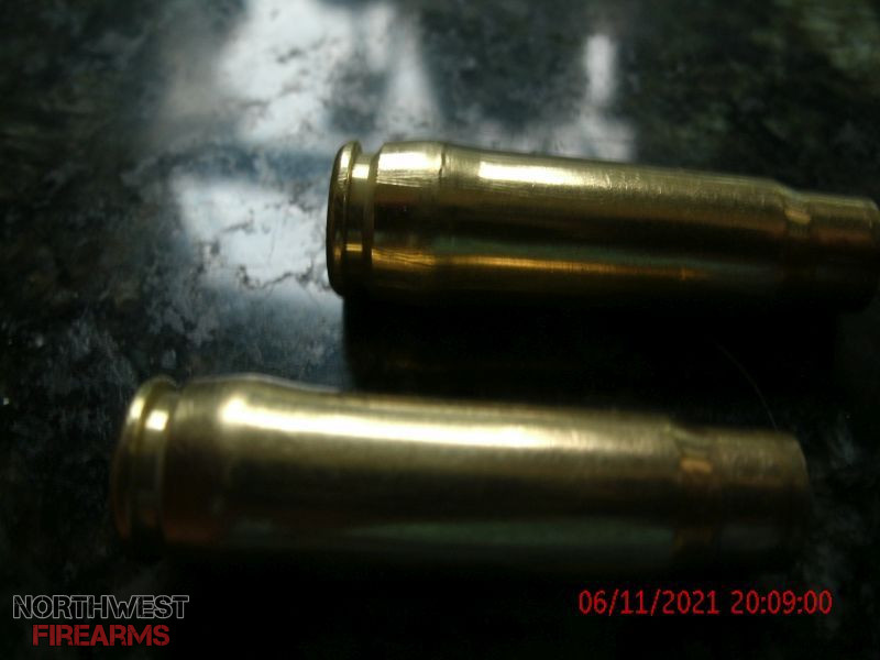

Recently came across some 7.63X39 Russian cases, which had severe bulging near the case web. These could easily separate, if loaded and fired again, don't know if you could even resize them. I wouldn't even try. Don't need a stuck case in my die.
I'm enclosing another picture with Berdan primed cases, which are easily recognized, do to the "RED" primers. 99% of the time, the primers of this color have Berdan primers, you won't need a flashlight to look down in the case.
These show the bulged cases, factory fresh fired primers, still in the cases. This is a problem with the rifle, has to be a "SEMI-AUTO" these are not fired in a bolt-action. There are even heavy extractor marks on the cases.

This is what I was thinking. More likely the gun than the ammo.
You guys are so right. It's hard enough getting a happy media, (different bullet weights) with an AR's timing (gas system) I can imagine the AK's with their bolt from hell, which can devour steel cases, then using a brass case in one. I suspect the gun owner, went thru 1,000 of steel cases, then got his hands on some brass. This could very well be the result.
The nice thing about cases being made of brass, once fired, they can tell you allot about the guns chamber and action.
