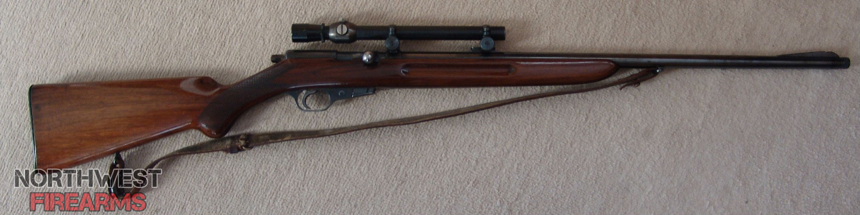

I learnt to shoot with this old Walther Sportmodel 2, used as a single-shot bolt action.
Then, after a while, as a five-shot repeater.
And then, sometime later, as a semi-auto.
My dad bought it in 1930, and having been almost blinded when he was detained by soldiers of the king after blowing up one of His Majesty's police stations back in 1921, he found that needed a scope to see better.
Everything is as original as it was back in 1930.
