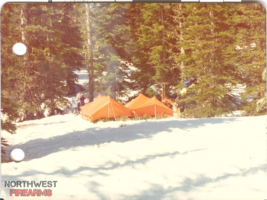

Needs to be narrowed down a bit as my provisions could fill a book as things change, sometimes considerably, considering time of year, terrain, geography, transport ability and my age, to name a few. Most of my younger backpacking life was in the summer with a 8X8 tarp, net hammock, light sleeping bag. Winter, a small low profile 2 person alpine tent, (gives enough room for my back pack and wiggle room) down bag and an 8X8 tarp to cover entry and cooking area..
But now, in my 70's, its a 16 foot trailer house, and an 8 X 8 tarp, carried with a 1 1/2 ton 4X4,
