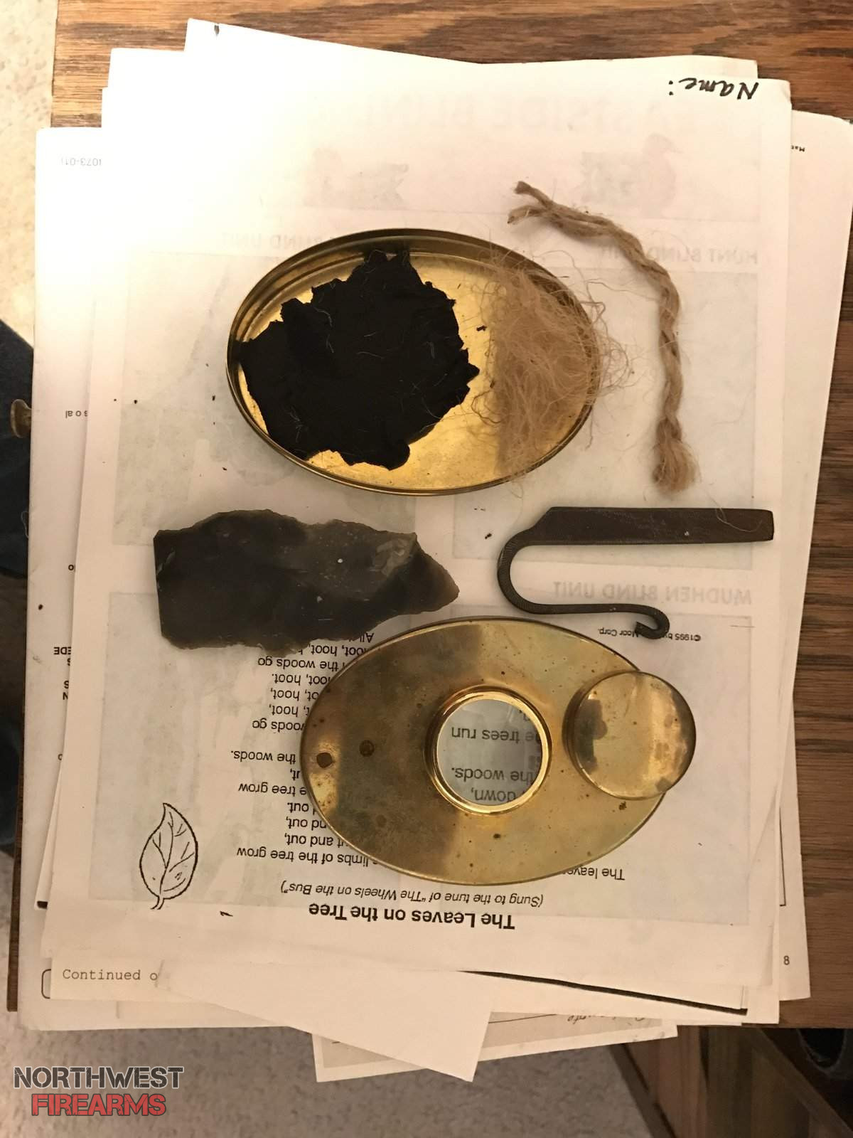

Here's my rendezvous kit. Ted Cash box with burning lense in the lid. Several pieces of char cloth (See Andy's post), flint, steel and some unwound sisal twine for tinder (this stuff is really fine and burns readily). If I really, really, really need to get a fire going I keep some cotton balls saturated with vaseline in a separate plastic container for some additional oomph on wet wood. Not traditional but they work.
Note: My best time for the firestart at rondy is 13seconds.
