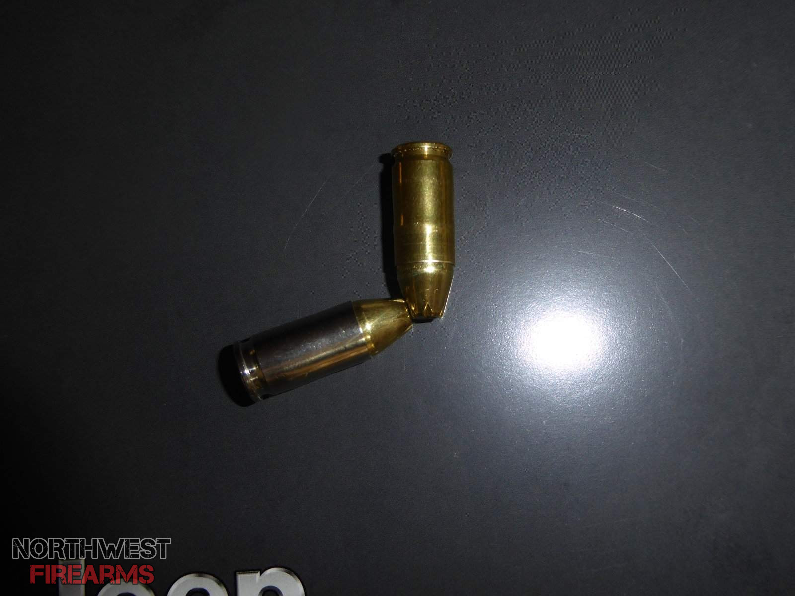

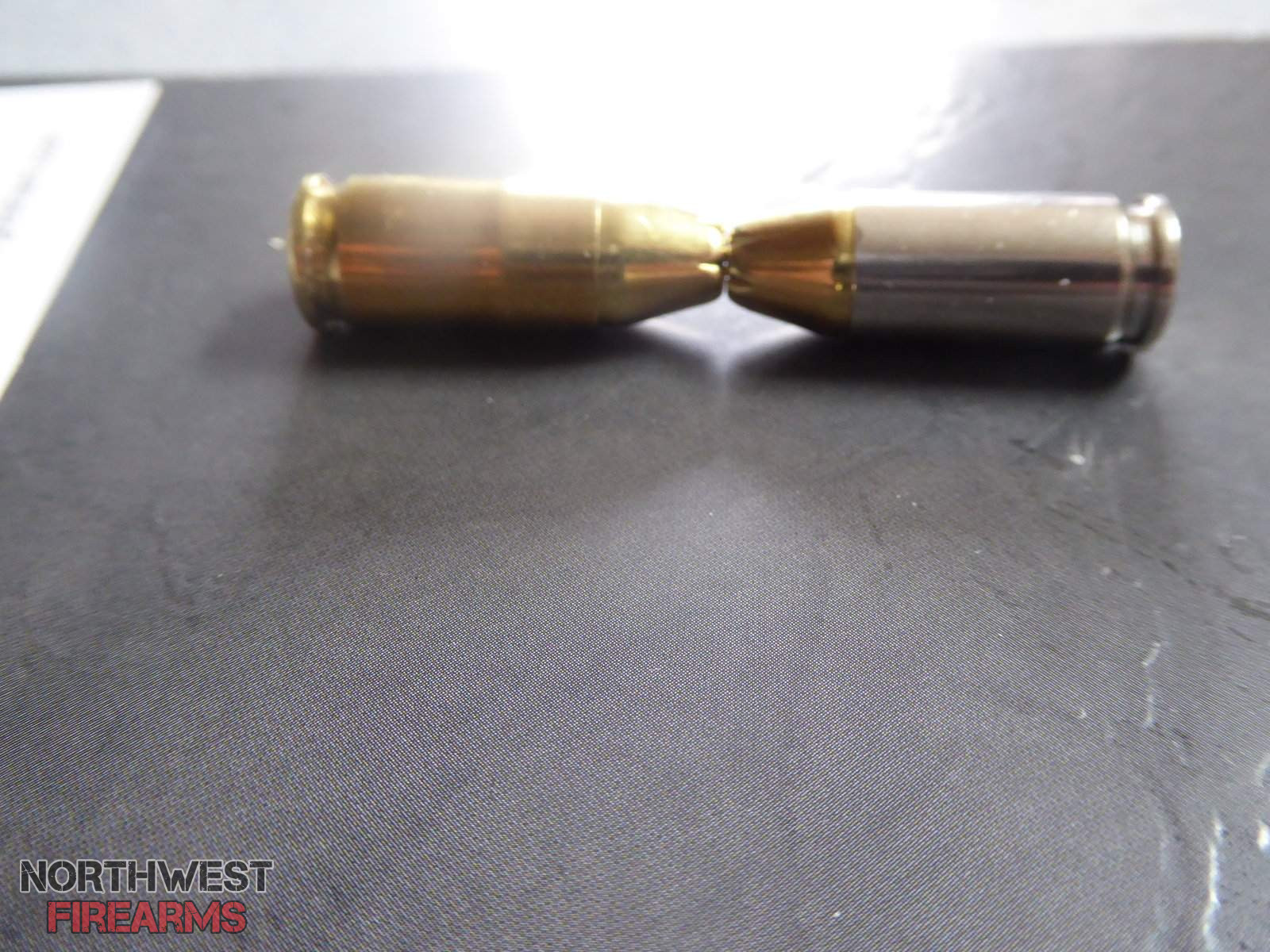

    So I'm reloading 9mm and I'm getting these bulging cases on the brass cases but not on the Zinc cases which are both using same exact setup/dies/powder/bullets/ect.....
    How is this possible. Each case is passing my case gauge prior to being put thru the reloading process.. With the bulging cases about 10-15 percent will not pass the case gauge after reloading is complete. Case will not go 100% into the case gauge on these few although they appear to be the same as the 90% that pass?

    I assume that they are all the same length case. If so I would say you have too much crimp as I have noticed that the plated casings are somewhat stronger and will take more abuse. I use a Lee factory crimp die as a fourth die because of this issue. Some do fine with a three die set by avoiding belling the mouth as much for seating and use very little to no crimp.

    I'm becoming convinced that the separate crimp die is going to be a must regardless of this issue but I will start with the crimping now... Cases are all pretty close in length.
    I've had similar issues with some .40 that some cases bulge and others don't.
    Thanks for feedback!

    Either too much crimp or the bullet isn't being seated perfectly straight.
    FWIW - I'm a big fan of separate seating & crimping and use a Lee FCD as it means I don't have to case gauge my finished rounds (handgun only).
    Dyjital likes this.

    Alright guys check this out. I backed off on my crimp die.. no change brass still bulges . Tried to different brass manufacturer.. the brass I've been having issues with is stamped CBC. Change to FC , blazer, RP, brass same settings NO bulge. Slight noticeable with S & B brass. Is this a brass quality issue?

    The unsupported case walls are getting distorted.
    Dies work for other brass.
    CBC brass real soft?
    Insufficient bell?
    Lube with graphite?
    Discard CBC brass?
    Some cases just don't work. I would move past them.

    If they won't fit the case gague they might still work fine in your pistol, unless you have a chamber the same size as your case gague (unlikely). Plunk some in your chamber and see if they fit. It's not unusual to see where the projectile bulges the case like that. CBC brass is usually pretty good. A Lee factory crimp die would likely make that round fit in the case gague better, but you will probably still be able to see that bulge. That brass might be a little thicker so the inside diameter is probably a little smaller, thus the bulge around the bullet.
    It could be that the brass is too thick/out of spec, but that wouldn't be a common occurrence. In my experience anyway. Very seldom run across bad brass.

    I'm guessing the brass is thicker so it in effect gets sized down too much and gets opened up again by the bullet being seated. You could back off the die so it doesn't crimp to see if this is the case or not.

    RCBS carbide dies on a PRO 2000. Again, after further workups 3 out of 4 brass brands seem to work without any "bulging"....

    Examine a bunch of rounds after each stage in the process. When you see the bulge, that's what's causing it. Over the years, sometimes mine was in flaring sometimes in the crimp.

    Both my Lee 9mm die sets do this (one set is from the mid 80s, one recent production). I've got the seater set so that it removes the bell, but doesn't 'crimp'.
    Thousands run through TP9 variants, XDMs, Sigs, Astras... Zero issues.
