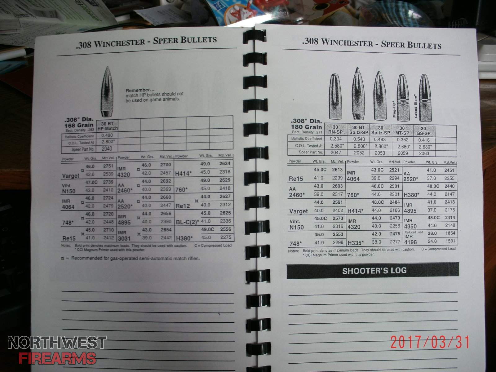

Why don't you just stop by and browse through my library:p.
Seems they very in size, most are large.
