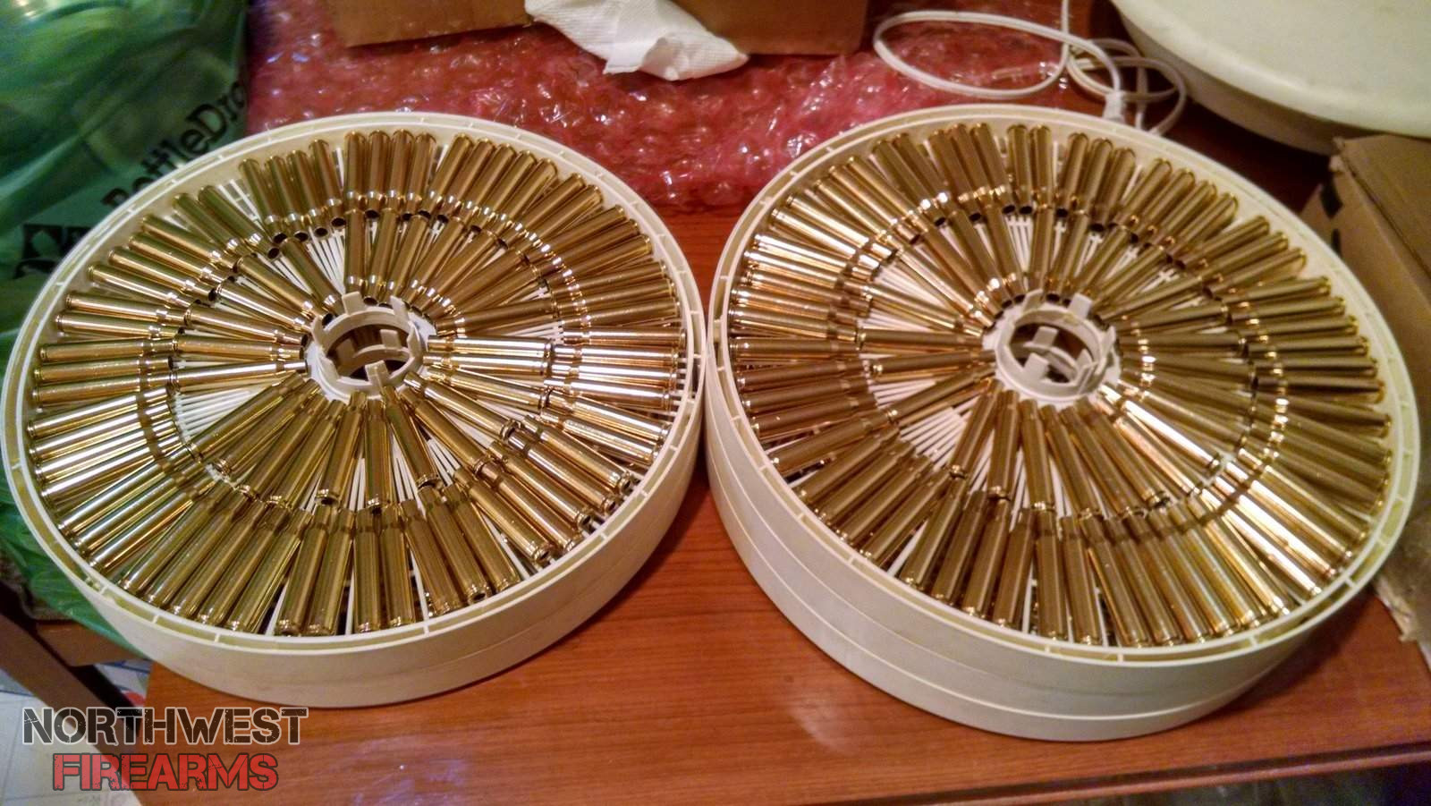

My DIY tumbler has a 2 gal capacity, I use 7# stainless pins, 1 teaspoon citric acid and 3 squirts of dawn dish soap.
I rinse well after tumbling then briefly soak the brass in a water/carwash&wax solution, rinse lightly, dry the outside on a towel then finish drying in a food dehydrator bupTzZZ.jpg H6IFXqH.jpg

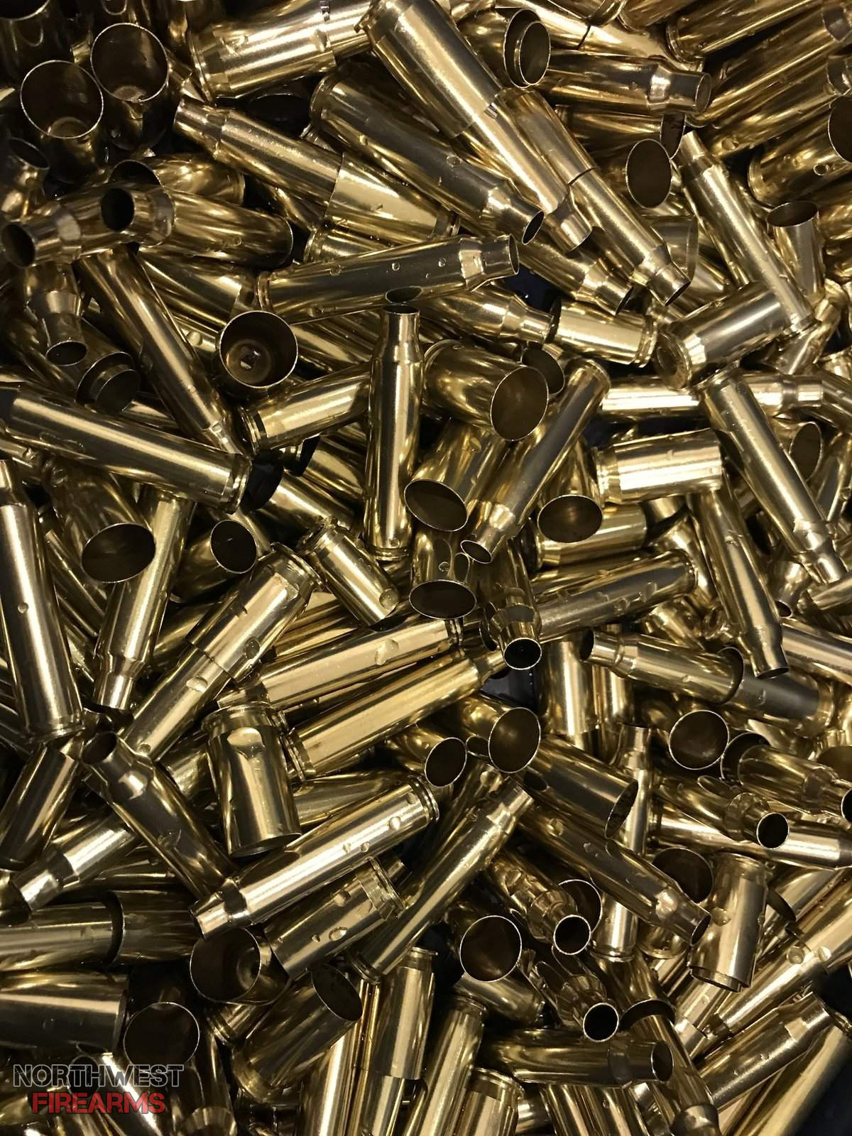

Good squirt of dawn and about 1/4 tsp Lemi-shine. 2-4 hours tumbled. While I am removing the brass and doing a thorough rinse, I pre-heat the oven to 265. I rock wet brass back and forth in a folded towel to knock off a bunch of wet, then spread the brass on a cookie sheet, turn off the oven, put the brass on the cookie sheet in the oven and leave for about 2 hours. Left in the oven too long brass get discolored....but are still really clean. We tumble in Walnut first to just clean it off. Then re-size/de-prime; trim as needed and camfur and de-bur. Then into the wet tumble as described above. When dry, we prime brass and store until ready to load 'em up. The reason we wet tumble last is because the stainless pins get the primer pockets really clean. Also, it reduces handling the brass after it is clean.
