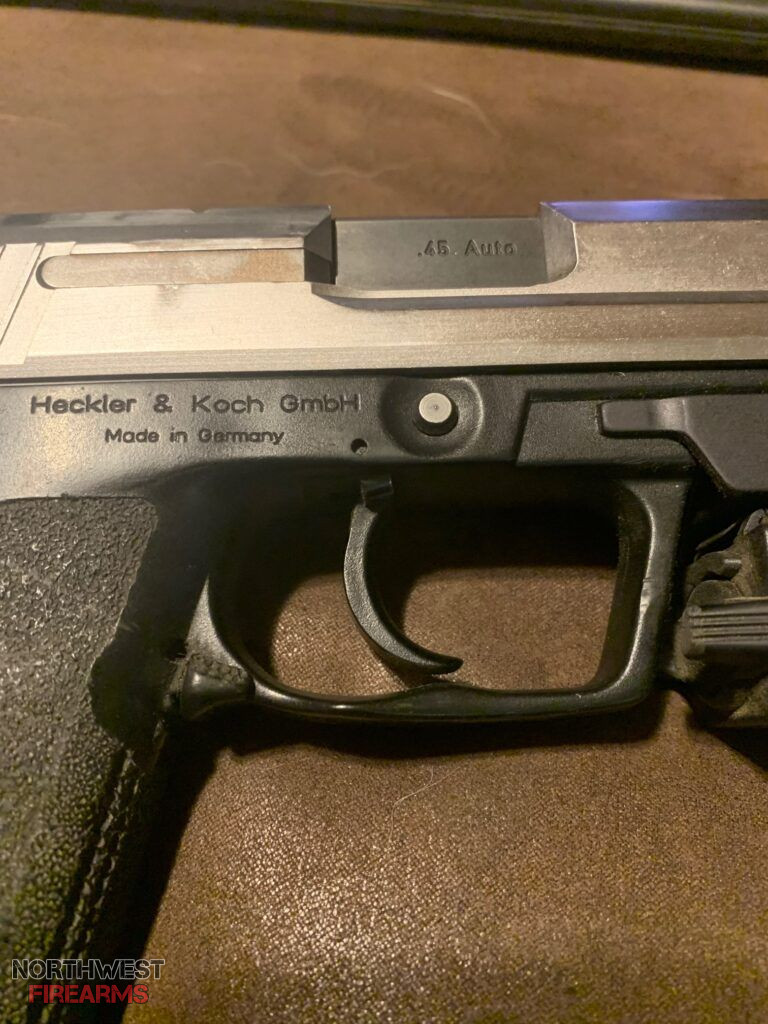

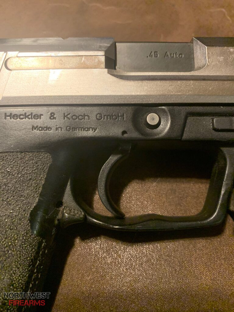

The two main style of trigger designs are rail or linear and cantilever. The cantilever is the most common and is pinned at the top of the trigger shoe and swings from that pivot point.
You will note in the picture and using the graphic below, that this style of trigger rotates down as it swings back. One of two things happen when you pull this type of trigger. Either your finger has to move downward with the trigger as it goes through it's arc pushing the trigger and therefore the muzzle down, or your finger has to move across the face of the trigger if you pull it straight back. You can mitigate this several different ways. One of the methods is to use as short a trigger swing as possible. Hence most people shoot better with a short trigger even if they don't know why that is. It is also why a lot of people like the flat face triggers that allow the trigger finger to roll across it as it swings.
