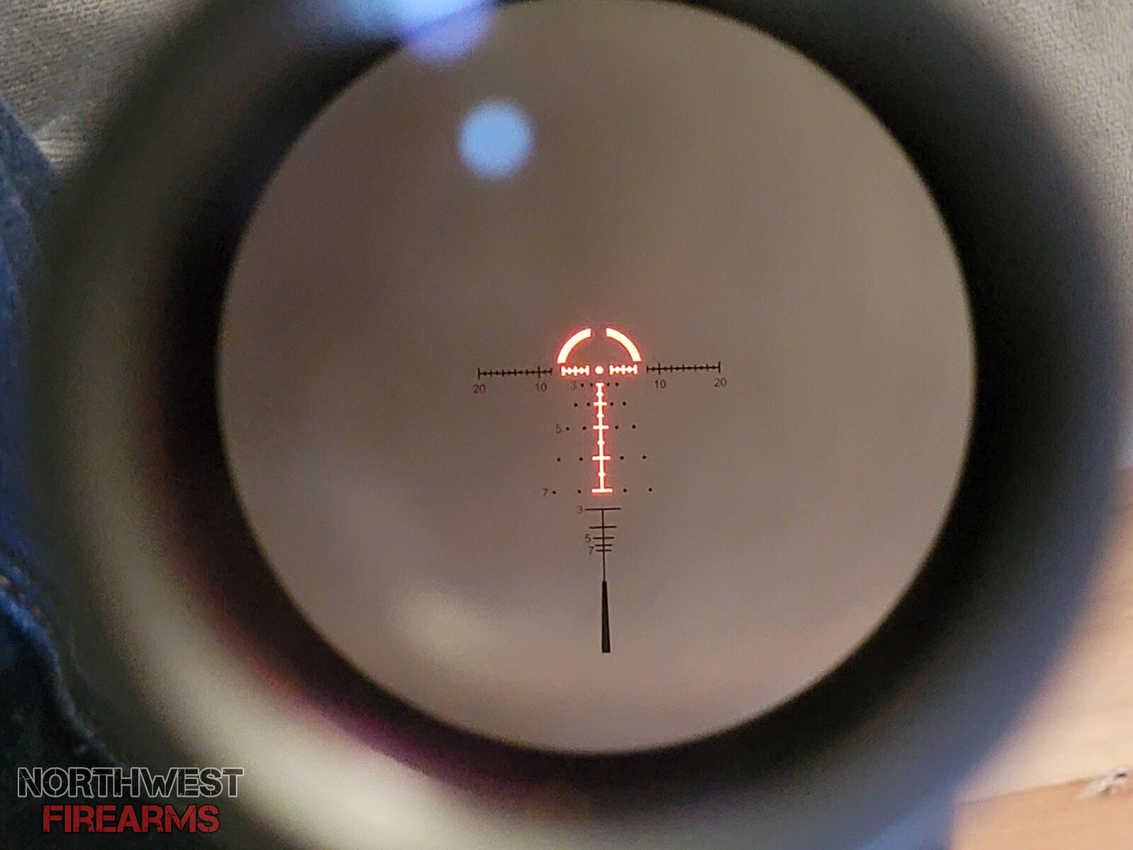

I just got an Athlon 1-10 and I'm actually pretty happy with it. Sighted in really quickly. Clear glass, zero stays put, daylight bright, so far so good. Only downsides are its a tad heavy and Not the best eye relief at 10x but for $400 it was hard to beat. Just work out more and find a good cheek weld :) Also have a strike eagle 1-8 that is super solid as well and there customer service can't be beat. Here is a couple pics of the athlon.

It has the same down sides of most cheaper scopes. The glass isn't amazing at full power, it's heavy, and its eats batteries at fast rate. The magnification throw leaver is also hard to turn without adding a longer throw leaver. It also seems to have some slight magnification at 1x.
I'm not sure how it compares to other options, but I've been very happy with it for the price.
Cool to hear the Athlon 1x-10x is decent! I've been wanting to check out one of the cheaper 1x-10x that have come on the market in the last couple years.
