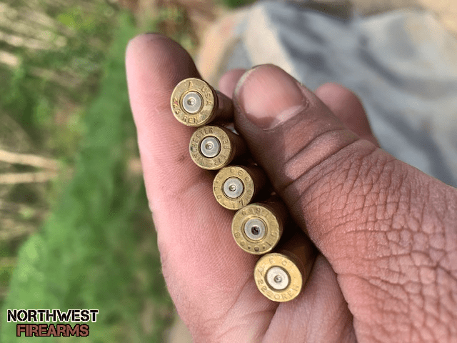

I did experience several pierced primers. Loads were Mk 311 frangible 50 grain projos using WC-844.
I have had some Rem 6 1/2 loads come out just fine (no pierced primers) but all were on the minimum/low charge side of load data.
You shouldn't use those primers with .223
Too much pressure for them. You can also ruin your bolt face quickly if you're piercing primers.
I had a brick of them from the Sandy Hook panic era, down to the last 200 of them. The very tip of the firing pin has erosion on it from the pierced primers :s0108: my fault entirely haha.
