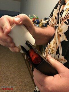

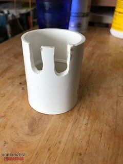

I found a guy on you tube that made one out of a piece of 1.5" PVC pipe. Cut a couple slots in it so it fits into the back of the magazine.
It doesn't have to be fancy, as you can tell by mine but it works great. The middle tab is about 7/16". I cut the slots with a 3/8" dremel bit.
No more sore thumb!
