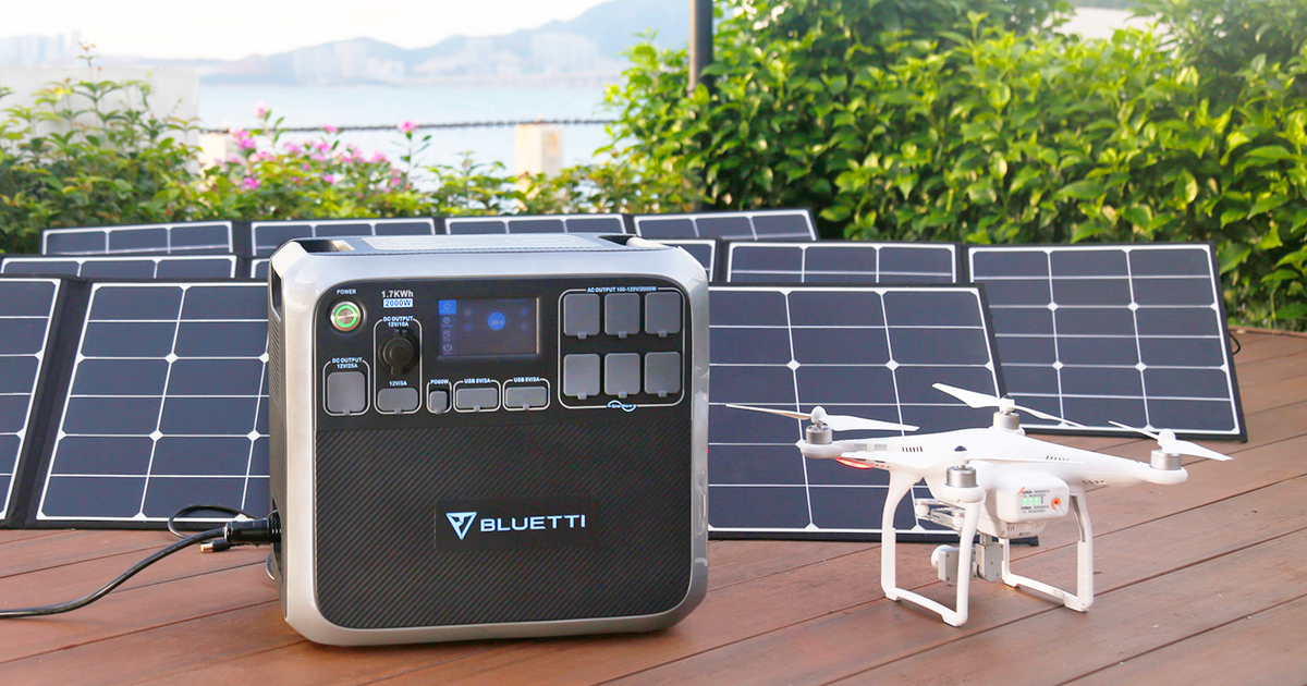

The Bluetti 200AC looks interesting. That $1600 price now hurts though.
I'll check out the link as well. I'd like something big enough to run a fridge so the Inergy and other systems that don't draw full power bummed me out.
Found out I am finally getting a commission on a house I sold June of LAST YEAR. Title issue didn't let it close. Since thats a surprise, I jumped into the deep end and went for the Bluetti AC200 with 2 120w panels and all the stuff. $2k total investment.
Wish I would have jumped on in at $999 or $1199, but study long, study wrong lol. (Actually didn't even know about it at those prices)
@Nick Burkhardt Can't wait to hear how your tests come out. Everything I've read is positive, so I'd expect good things!
