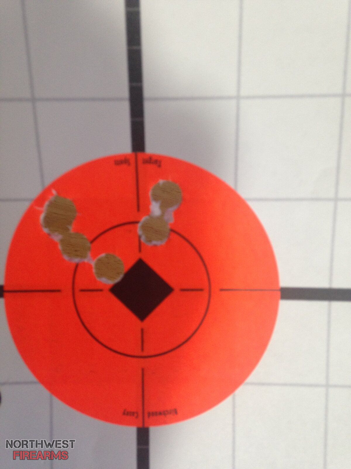

Ok so I pick up my Henry BBB .357 and, after having to re-zero it due to a front sight swap I shoot the attached six shot group at 50 yards with 'open irons' (Receiver peep W/blade front) .
I don't get it. I have NEVER had this much of a problem shooting a rifle with a scope - the wild card is I shoot the PCC very well with the stock sights - even getting a couple 1.5" rested groups at 50 yards.
Any thoughts or ideas as to a reason for this ?

Did you notice the six shot group shot minutes later with 'open irons' on my Henry .357?
AND I can hold 1.5" + groups with the PCC with its stock sights.
I am beginning to agree with the scope mounts shifting as the problem.
