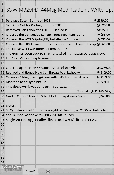

Ok,,,,,, here you go, these numbers are not Gospel, I did all of the work myself, less the Porting, I was asked about Cost's, so I put this spread-sheet together for a guy to see what his Cost's might be, if he were to send it out to a Gunsmith, rather than do it in-house...... That's my Story, and I'm Sticking to it.......:cool:

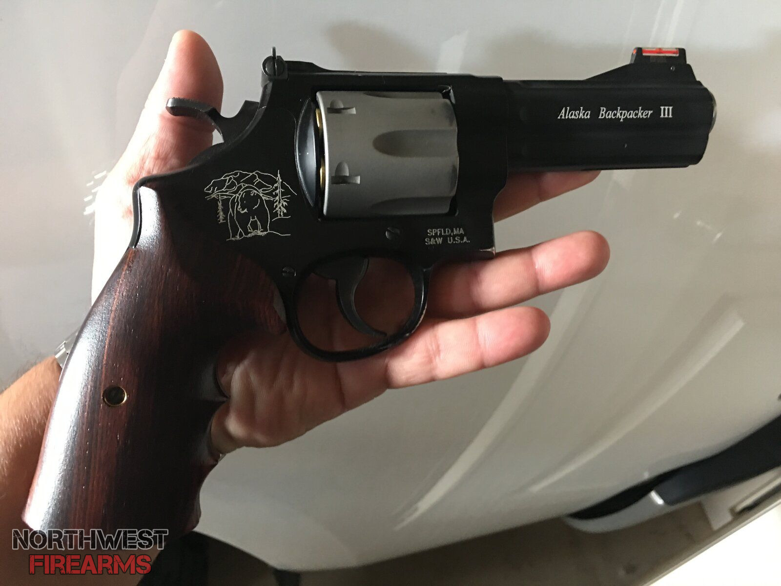

Im sure you have seen these. Im from FBKS, got it up there. Sounds like S&W only made a few hundred of them and sent them all to AK. All my buddies were getting them so, when in rome. I pack it around in my guides choice once a year when i go back to AK for moose hunt. IMG_1867.jpg
