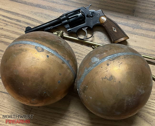

On another note- I found these while cleaning out some old junk at work. They're big and they clang, and I've heard that it's manly somehow to have a pair, so I brought them home...

Lol

Lol! Thanks for sharing!
