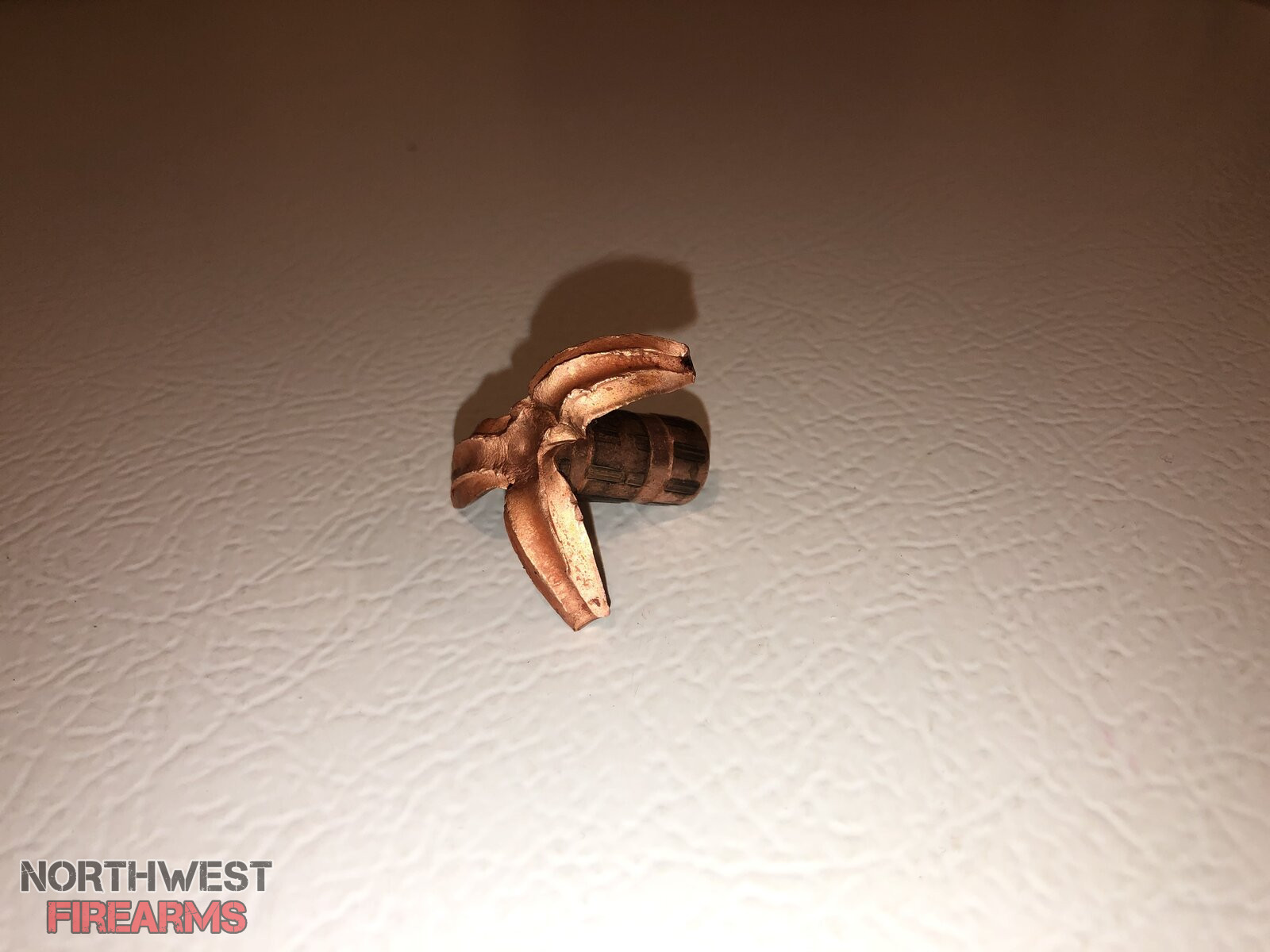

And here again is a recovered 500gr maker rex recovered from the blacktail buck in my avatar. It was launched at 1000fps from my 458 socom and resulted in a instant death.
117818AF-3FBD-4C54-9979-BA3EFE754D8C.jpeg D3498A28-CBF9-4DD4-AD6D-07A6C050B2F6.jpeg
