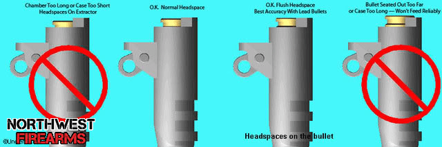

So much for thinking I had a good understanding of this process. Rounds fit in magazine ok, fit nicely in head space gauge but I'm way longer than I'm seeing posted. Guess I missed a critical read.
When I develop pistol rounds I remove the barrel and drop them in to check if they fit. If that happened to me I think I would drop the mag and attempt free it up at home, outside in a safe direction while another adult was present in a safe area. That way if anything did go wrong you are close to medical help. Not gonna happen in the woods with no cell sevice. Youll probably have to slip a short tube over the barrel against the face of the slide and tap it back open with a mallet. What ever you decide to do will be at your own risk. Everything I do is:) Good luck!
Yea, your barrel is the best case/cartridge gauge. It should "plunk" in.. ie pass the plunk test by just falling in with a plunk to proper depth.

I used that method to get to the point where I thought I was right (except the part about putting them in the chamber) because I thought I understood the LEE headspace guage I bought as something other than what it was...... Next time!

On Wifey's Kimber Pro Aegis I had to reduce OAL to 1.085 using Montana Gold 125gr JHPs, 1.095 and it doesn't pass the "Plunk Test". It's wasn't an issue with the first loads I did with Speer 115gr RN bullets. The Kimber had the lands way closer to the chamber than any of our other 9mm arms. there never was an issue with the extractor locked on the rim of the bullet though. The gun wouldn't go into battery is all.
My concern, when shortening the OAL so much, would be pressure. Maybe not so much an issue in a full size, but in an LC9, or KelTec PF9/P11 type gun?
