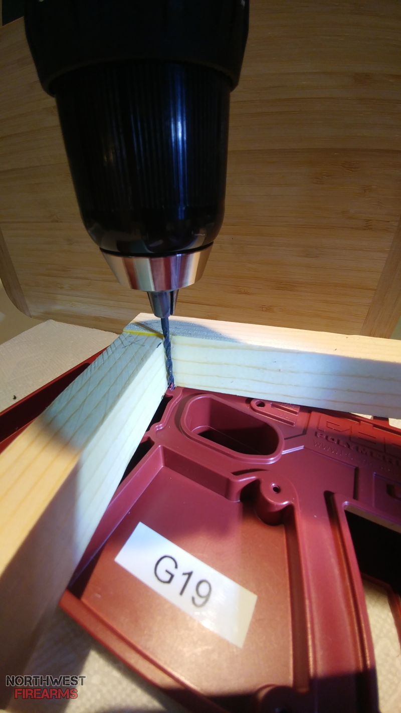

I actually do use a drill press on mine. Its just easier for me that way personally. What works for me may not for you.. I tape the side up and make sure they are square then i line em up and jog the quill up and down through the hole to make sure im centered (with plumbers sealant Tape) and then drill. Easy and way more accurate.
I tried marine gun builders method and it was a joke. Worst hole i ever drilled in one. I was using a fordome as well. Much better/easier to use than his dremel.
Agree, using a Dremel for the hole seems like a terrible idea to be sending out to the masses.
If you are having success with the drill press, stay with that by all means.
Polymer 80 said that they have had a lot of comebacks from amateurs not knowing how to set up their drill press.
Others were drilling completely through and mucking up the far side holes.
Another thing I'll add is that if you drill at a lower RPM you'll get cleaner holes.
Spinning the bit too fast will start melting the frame material which is a giant no-no.
Also check drill bit trueness as well as drill motor trueness before drilling.
Do this by observing the chucked up and turning bit.
A bent drill bit or cheap, wobbly drill motor needs to stay away from this project.
Accurate and true holes are the key to a successful P80 build.
It's the first thing I look at when someone shows a pic of their P80 build.

Double Jig Method
The drill jig needs to made up square and with legs long enough to span completely across the P80 jig.
Use high quality wood glue an let set up overnight.
The purpose of the drill jig is to keep your drill bit square with the frame.
The location of the drill bit is for demonstration only.
ETA
Polymer 80 recommends against using a drill press for this operation.
